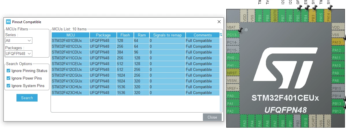

DRums.1
Jan 11, 2022 4:45 PM UTC
Hi Guys. I try to mirgate a Project in CubeMX, based on the STM32F401CE controller to the STM32F401CC controller.
CubeIDE: Version: 1.8.0 Build: 11526_20211125_0815 (UTC)
CubeMX: version: 6.4.0.202111222105
OS: Windows 10
I tried to open the IOC file in CibeIDE, go to Pinout -> List pincompatible MCUs
From the UM1718 (CubeMX documentation), I expected an "ok Import" button. In the window named "pinout compatible dialog".
Looking at my, cubeIDE output, it lists the compatibel MCUs but I cannot choose any to generate a new project.
0693W00000HrHjRQAV.pngIs it essential to install CubeMX to do the migration or should this also work in CubeIDE? If so, how?
Many thanks for your help
Jan 11, 2022 4:55 PM UTC
I stand by my original statement.
Projects created in STM32CubeIDE cannot be migrated in any automated fashion. Projects created in CubeMX can, sort of, but user code is lost in translation.
https://community.st.com/s/article/mcu1-to-mcu2-migration-option-within-stm32cubeide

DRums.1
Jan 16, 2022 6:20 PM UTC
Ok. I did it, as suggested. I auto generated the CubeMX settings as describe by Osto, above. Then I manually copied all source files, as TDK suggests. BUT:
In my case, CubeMX code generation did not import the clock settings correctly! Most of the settings were imported but not the PLL source Mux (to HSE) and the system clock Mux (to PLLCLK). Have a look at those settings, when you import a project like this.
Osto
Senior
Jan 17, 2022 3:05 PM UTC
Try to do the same with CubeMx instead of CubeIDE. CubeMx is in my opinion more relaible than CubeIDE.
The best but most time intensive way is to enter all values in a new project of the new MCU. So you are not limited with possibilities of the tool but on MCUs with big pincount or very complicated projects, this could be very time intensive.
