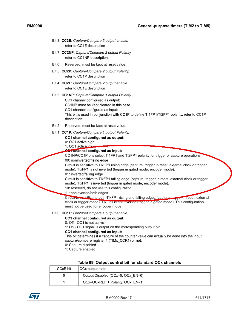

Is somehow possible to detect rising and falling edge of input signal ?
HI,
I'm using STM32f4 and I'm trying to calculate rotation speed using Hall sensors.
Idea is to use TIM4 and 3 Hall sensors in 3 channels in caputre compare mode to calculate time between two edges. I know how to do that, but the problem is that I need information about the falling or rising edge to know on what angle is rotor.
I need angle to calculate rotation speed, the difference between to captures will never be exactly 60 deegres.
I' am also planing to do calibration of hall sensors to know angle precisely .
So is it possible to detect rising/falling edge using timer or is there some other way to do it ?

At a time you can either capture rising edge or falling edge but there is a solution initially set the register for capture the rising edge then in interrupt change that register to capture the falling edge of the pulse . 1st store the count value when rising edge is detected and when faling edge is detected minus the current counter from previous counter. this way you can measure the frequency(pulse length).

There is also an indirect mode allow for a single pin to go to two channels so for example CH1 and CH2 can capture opposite edges.​

Look up PWM input mode in the reference manual.
