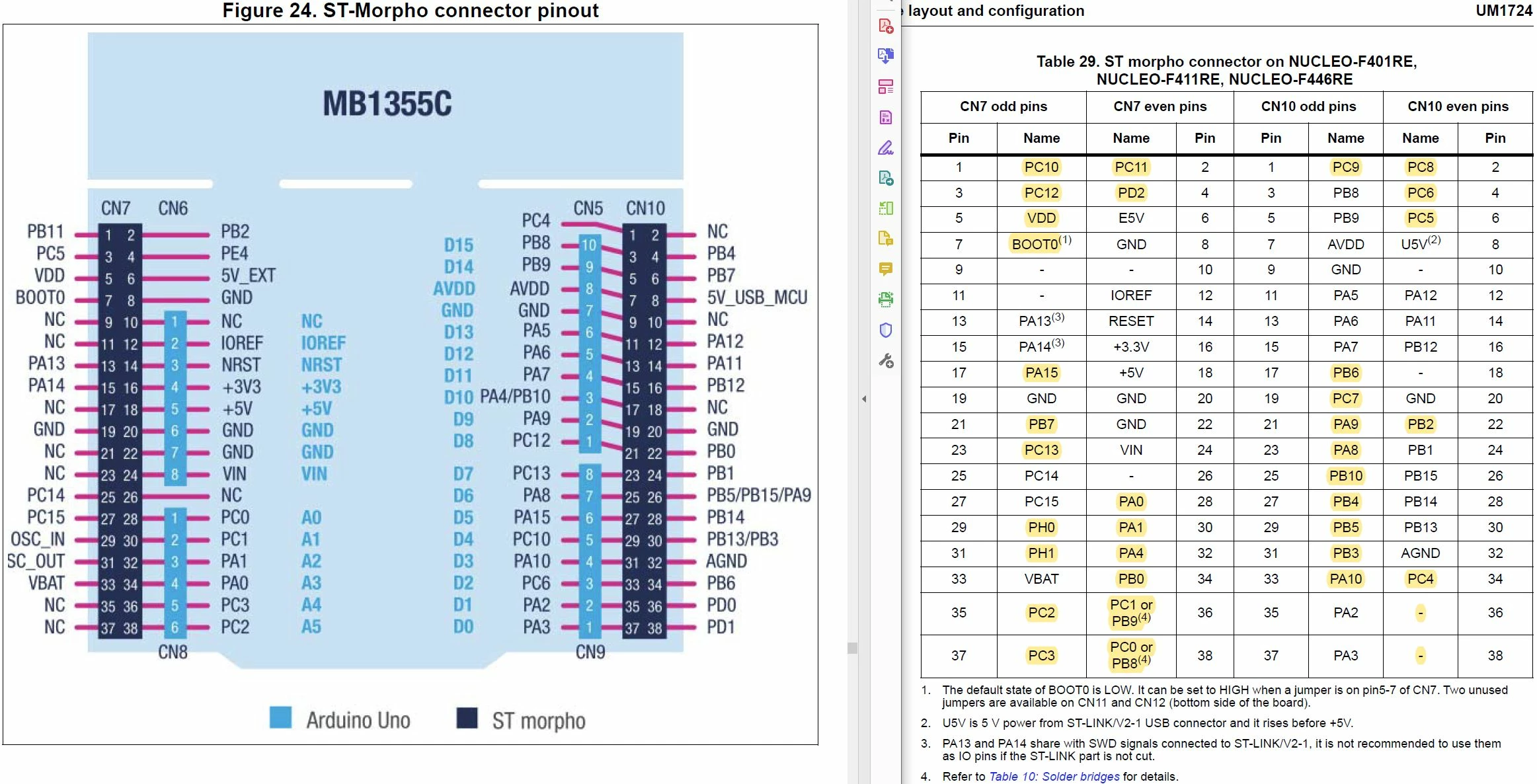

Is it possible to use X-NUCLEO-IHM17M1 expansion board with P-NUCLEO-WB55 board?
I would like to use X-NUCLEO-IHM17M1 motor control expansion board together with P-NUCLEO-WB55 board. I assume that there is hw compatibility but what is the mounting option to be used (I expect it is different with respect to NUCLEO-F401RE or others NUCLEO boards specific for Motor Control)?

Dear @Laurent Ca...​ ,
thank you for your support.
For the coding part I plan to use just Simulink with STM32-MAT/TARGET in order to have full control over the implemented algorithm, so I will not make use of STM32 Motor Control SDK.
My main concern is to find the right hw setup ('mounting option') of the X-NUCLEO-IHM17M1 expansion board when connected to the P-NUCLEO-WB55 board.
The expansion board User Manual (UM2360, Section 5) only details the mounting options for the following boards:
• NUCLEO-F401RE
• NUCLEO-F302R8
• NUCLEO-F103RB
• NUCLEO-F030R8
but I would expect that a specific mounting option could be available for P-NUCLEO-WB55 to drive the right signals. This would let me test a remote motor control implementation over OpenThread wireless network.
thanks for the suggestion. Unfortunately UM2435 is focusing on BLE and 802.15.4 applications and do not mention motor control. Based on it I can just do the following comparison between Morpho connector on Nucleo-WB55 and Nucleo-F401RE (ref. UM1724):
0693W000008wMgvQAE.jpgwhere I highlighted any different signal. Nevertheless this is not enough to define how to setup X-NUCLEO-IHM17M1 stacked on P-NUCLEO-WB55 instead of NUCLEO-F401RE.
Best regards,
