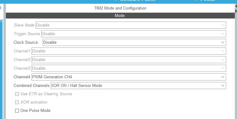

Is it possible to use Hall sensor mode(x3 CH) and PWM function(x1 CH) at the same time in the timer?
  • September 8, 2023
  • 1869 views
I use TIM2 in Hall Sensor Mode and
I want to use the unused channel 4 for PWM generation.
There are no conflicts in CubeMX configuration.
Are there any problems with the actual operation?
    Best answer by Issamos
    Hello @monbot
    all Channels are independent. Then, you can use the  Ch4 for PWM generation.
    Best regards.

    waclawek.jan
    September 8, 2023
    All 4 channels of timer are mutually independent, except they work out of the same single counter. So, as long as you don't change anything in the counter's setup (including prescaler and source of clock/slave-mode controller setup), the fourth channel works as intended regardless of the other 3 channel's setup.
