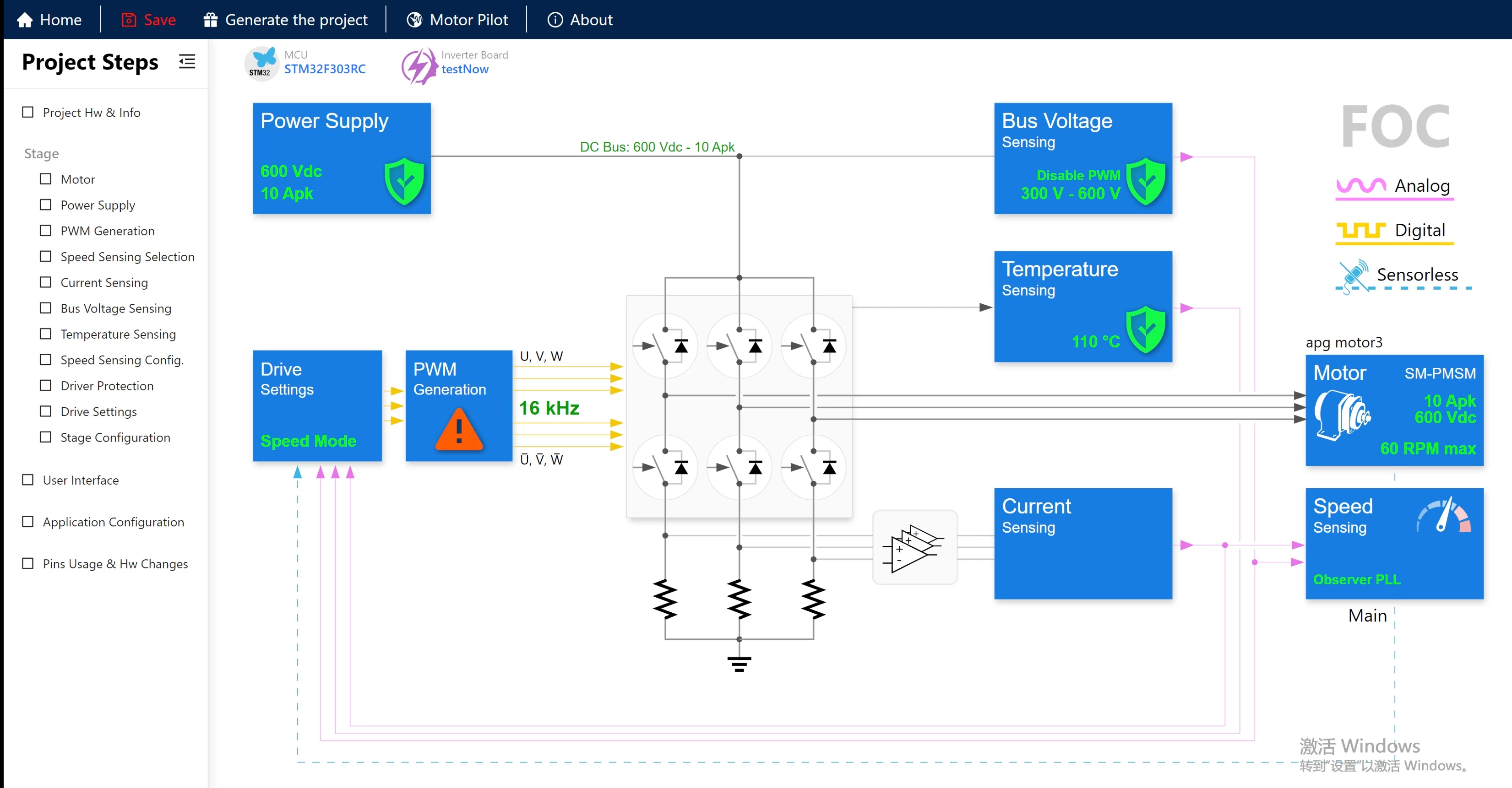

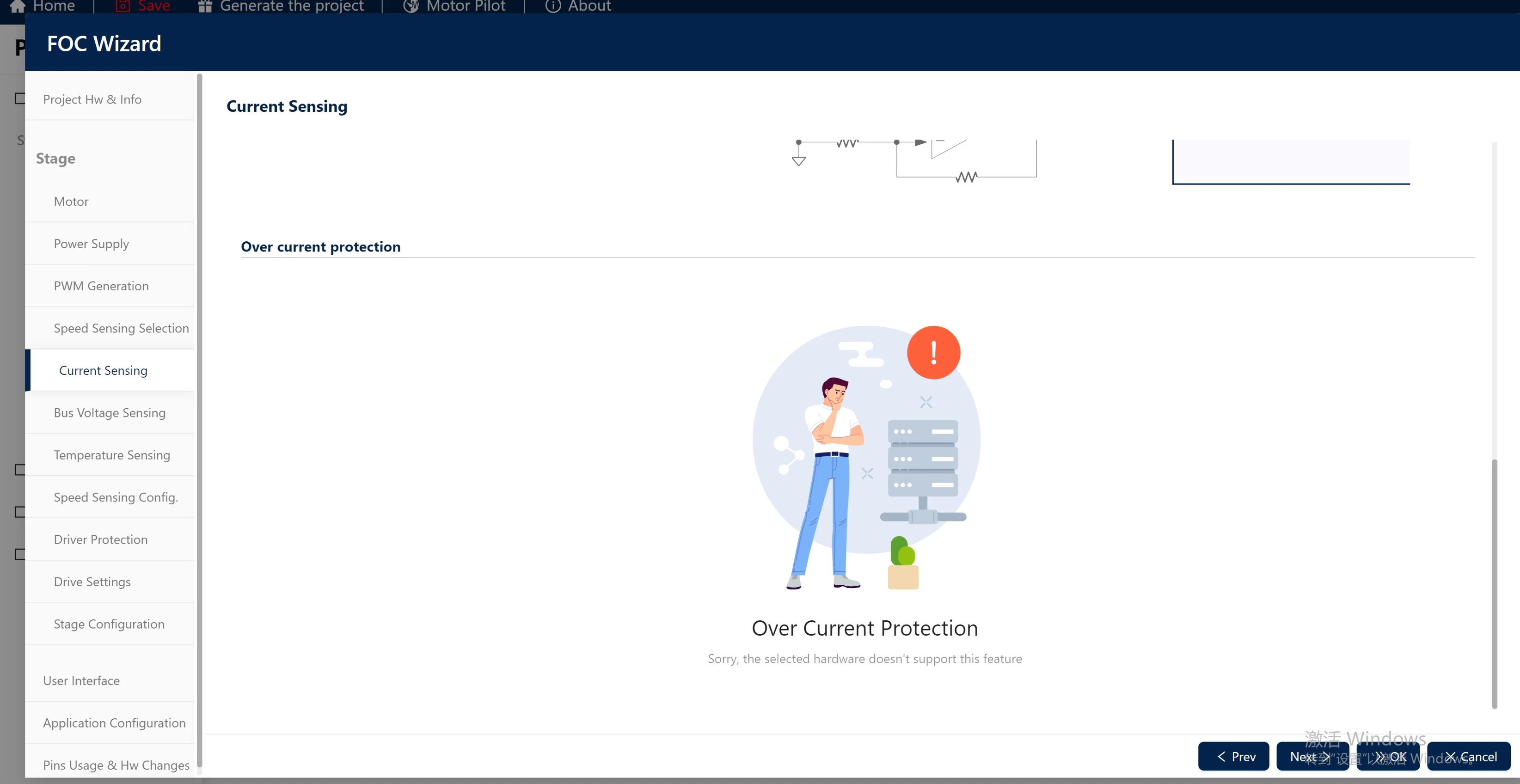

    the over current protection is not show on. I don't know why?截屏2024-03-29 17.34.52.jpg
    Mar 30, 2024 2:29 AM UTC
    it's ok now. I changed the oc_trigger pin to PA2(TIMx_BKIN).I hadn't noticed it before.

    and the foc wizard show:截屏2024-03-30 10.28.41.jpg
