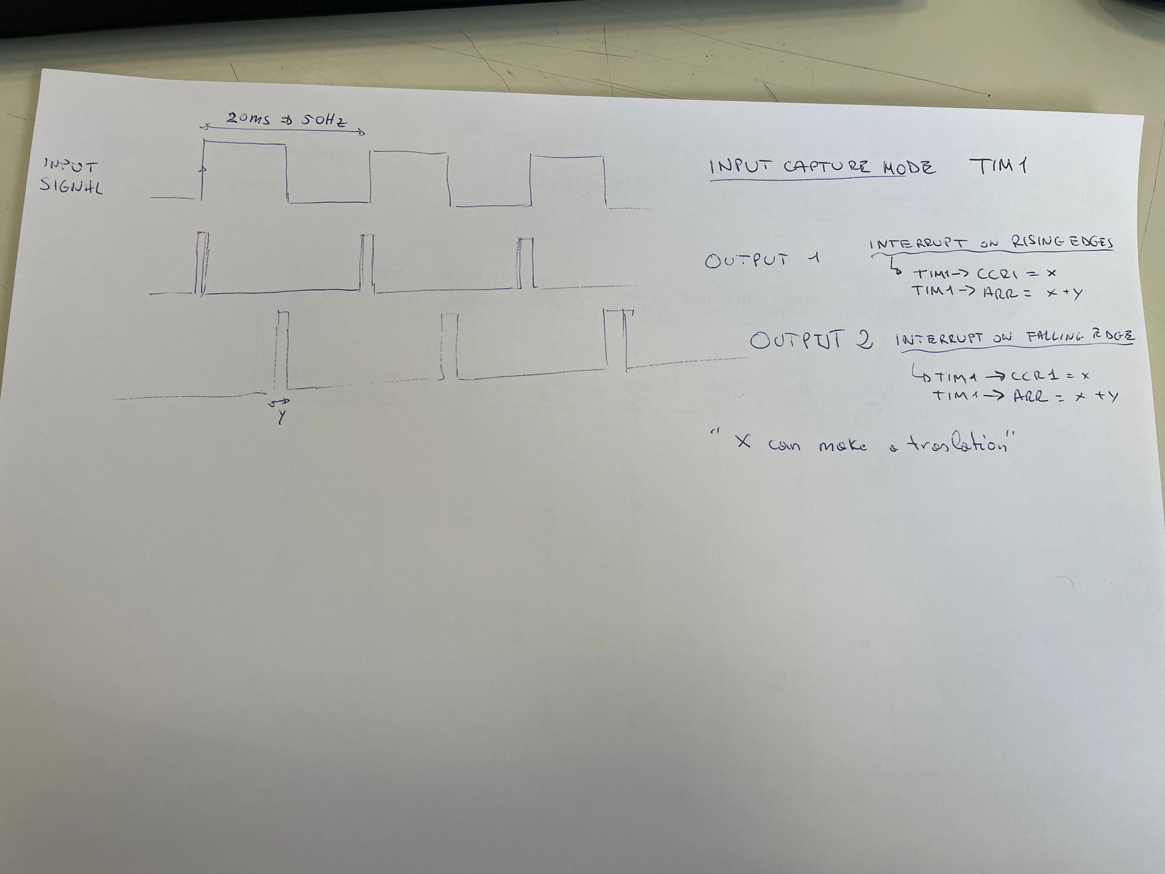

i have an external signal , this is a square wave of 20 ms of period. i will put this signal on input capture channel of the timer.
i want to generate interrupts on rising and falling edge of input capture , but i want to do it in separate or differently output as the photo 0693W00000NpMB0QAN.jpg

Why do you need to discriminate between rising and falling edges? it looks like you trigger the same pulse in both

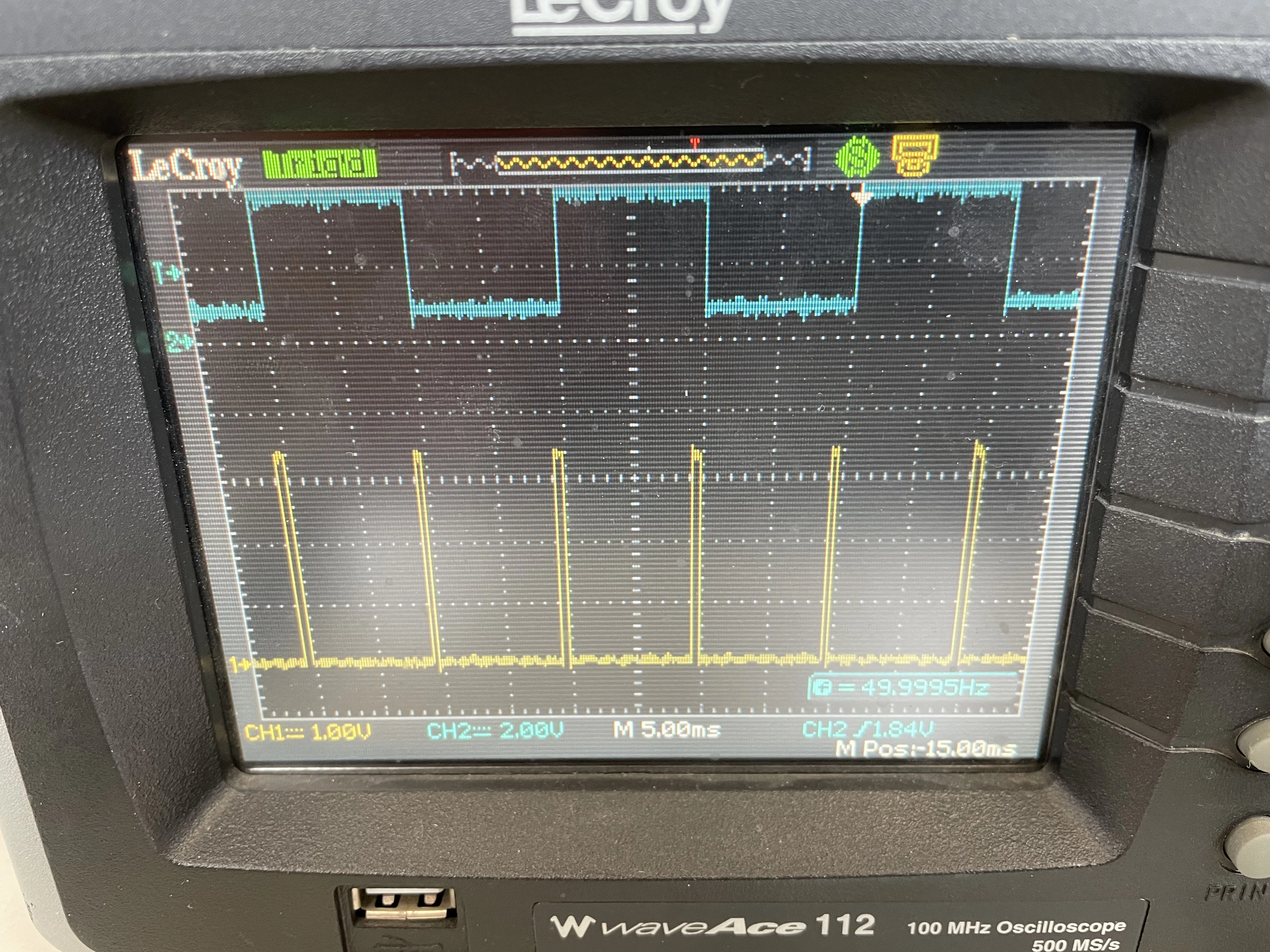

at the moment with this code i have only one output and the pulses are 10ms of period but i want two differently output like the first photo

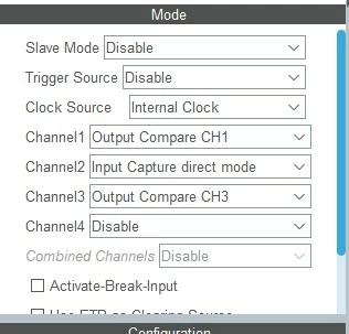

i am using this configuration. Should have 2 outputs and 1 input signal that is an external square wave0693W00000NpMuKQAV.jpg
