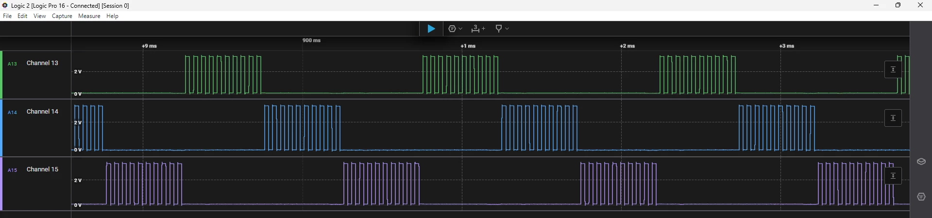

I am trying to use the X-NUCLEO-IHM07M1 motor development kit with a custom FPGA pwm controller
I am just trying to spin a motor in open loop and no feedback or speed control
I am planning to feed the 3 phase pwm signal to IN1, IN2 and IN3 and supply 9v to the IHM07M1 board.
Im wondering what else i need to take care of , any enable signals to be toggled ?
what is the role of ENx signals are they to be toggled with the INx pins ?

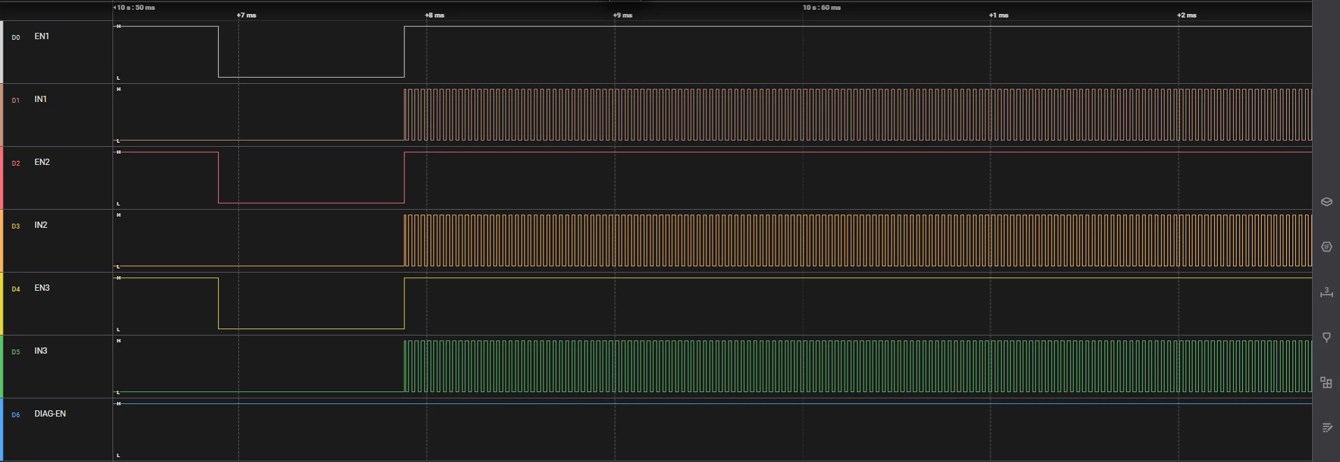

    I was able to get the motor profiler application running to check if my setup is good and then,
    I probed the ENx lines with a logic analyzer looks like they are normally low and then toggled once and held high once the application starts.
    DIAG-EN seems to be driven identical to ENx for the most part except its not toggled always held high,
    but you need to handle overcurrent and thermal protection through your circuit/code as per the datasheet.
