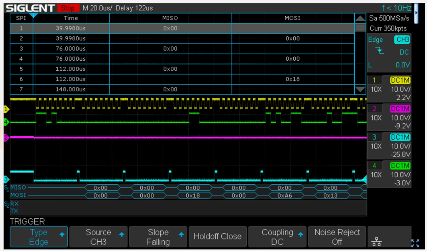

Problem description
  1. The STBY/RESET pin is set to LOW by hardware configuration before it is set to LOW again by software control through a controller chip.
    1. This is observed in the blue line during the first 3 grid blocks in GRAPH 01 below, where the pin is set to low first and there is a slight dip in the LOW voltage which marks the point where the pin is set to LOW using the controller chip software.
  2. To perform the initialization of PowerStep01 chip, the STBY/RESET pin is set to HIGH and the status register 0x0D is read as the first step of initialization.
    1. PowerStep01 responds with 0x0000 as the status register value which suggests that the chip is in a faulty state.
      1. This is seen in the pink MISO line in GRAPH02 which is a response to reading of 0x0D status register on green line in GRAPH 02
  3. When the PowerStep01 chip is in this state, the initialization sequence fails, and it does not respond to any other motor control commands.
  4. This only happens on some devices and on some other devices the same initialization sequence works fine.

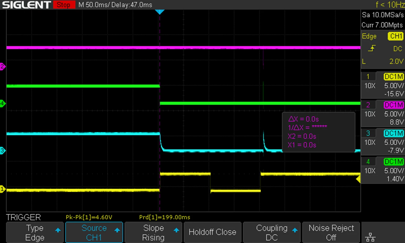

Legend for the graph 01
  • Blue : STBY/RESET Pin 10
  • Yellow : Clock
  • Green : MOSI
  • Pink: MISO
GRAPH 01
Legend for the graph 02
  • Blue : CHIP SELECT
  • Yellow : Clock
  • Green : MOSI
  • Pink: MISO
GRAPH 02

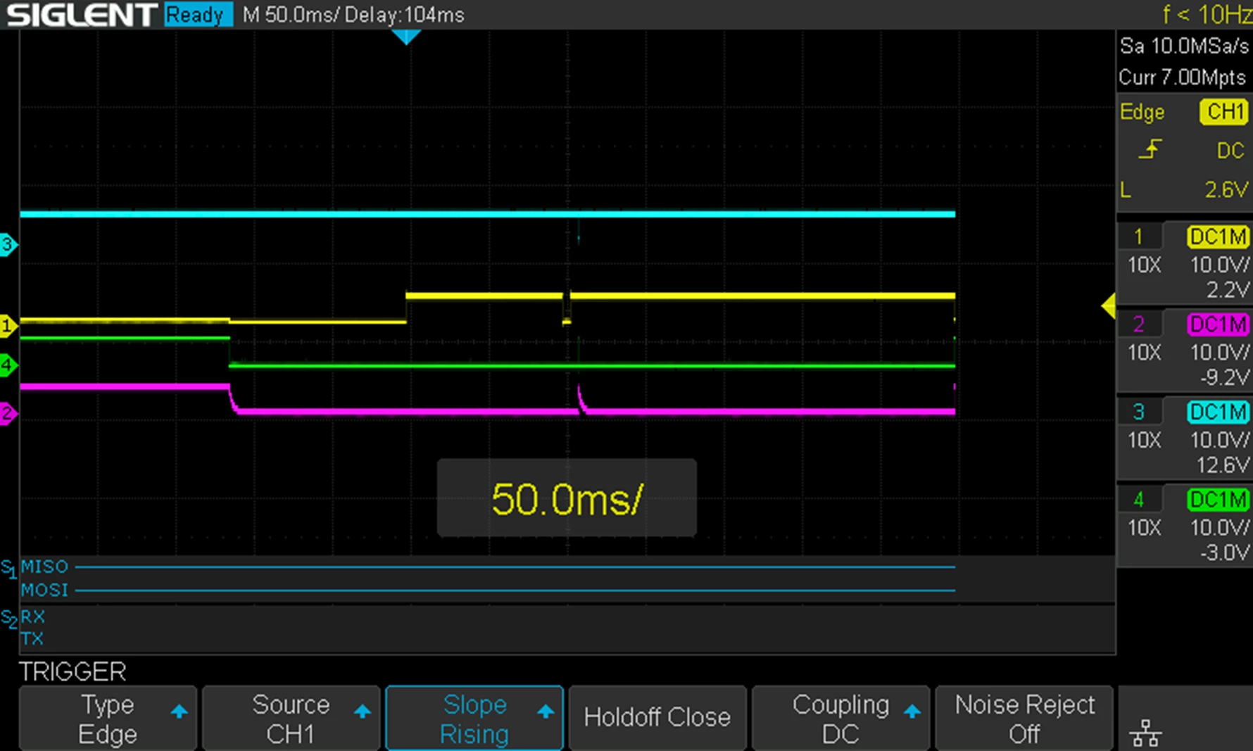

Solution A
Note: The legend colors have changed compared to GRAPH01
Based on information gather from forums,  a reset pulse was introduced into the startup sequence as seen in the GRAPH03 below
  • The initial situation is same as in GRAPH01
    • Power-up starts with a hardware pulldown to LOW, followed by a Software controlled pull down through a controller chip seen as the slight dip in the yellow line.
  • 100ms into the software-controlled pulldown to LOW, the STBY/RESET Pin is set to HIGH for 100ms and then set to LOW again for 5ms.
    • This is the additional reset pulse based on info gathered from different forums
  • After the 5ms setting of STBY/RESET Pin 10 to LOW, this pin is set to HIGH again and the initialization step is carried as done in step 2 in problem description chapter.
    • Reading status register 0x0D,  and PowerStep01 responds with 0xE603 (The compressed pink spike in GRAPH03 below)
  • From this stage onwards the PopwerStep01 chip works as expected, and status register reads 0xE712 when tried to run the motor.
Legend for the graph 03
  • Yellow : STBY/RESET Pin 10
  • Green : MOSI
  • Pink: MISO
GRAPH 03

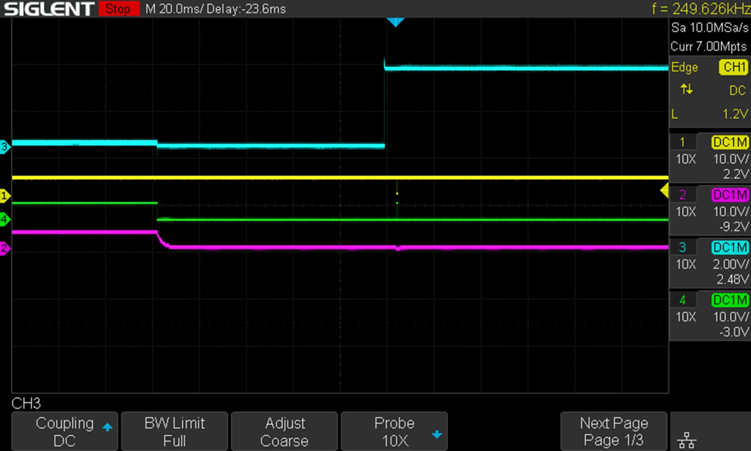

Need for Solution B
  1. The solution A had one of the temporary fix attempts where the initial software-controlled setting of STBY/RESET pin to LOW was delayed for about 1-2 seconds after power-up.
  2. When Solution A worked, this temporary solution was removed, and initial software-controlled setting of STBY/RESET pin was done soon after powerup. This also means that the graph does not capture(due to time solution settings of the oscilloscope) the slight dip in LOW voltage when transitioning from Hardware pull down to LOW and software-controlled transition to LOW
  3. This meant that now the software-controlled pull down of  STBY/RESET was done longer than in Solution A.
    1. Initially this pin is pulldown to LOW
    2. The controller chip then pulls it down to LOW for about 800-1000ms
    3. The pin is set to HIGH for 100ms before setting it to LOW again for 5ms (Yellow Line)
    4. The pin is then set to HIGH and Initialization sequence is performed which seems to fail again.
      1. In this state PowerStep01 responded with 0xE603 to status register read.
      2. But when attempting to run the motor the status register reported 0xE613 (HiZ)
  4. The original problem now resurfaces again, although not 100% exactly as the original problem but the consequence is the same i.e., motor does not rotate.
Legend for the graph 04
  • Blue : MISO
  • Green : MOSI
  • Pink: ChipSelect
GRAPH04

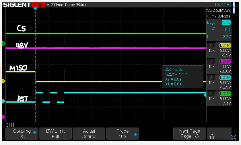

Solution B
  1. The new problem is solved increasing the setting of STBY/RESET pin to LOW from 5ms to 100ms
    2. The controller chip then pulls it down to LOW for about 800-1000ms (as before)
    3. The pin is set to HIGH for 100ms before setting it to LOW again for 100ms (Yellow Line)
    4. The pin is then set to HIGH, and the initialization sequence is performed.
    5. The setup works as expected and is stable.
Legend for the graph 05
  • Blue : MISO
  • Green : MOSI
  • Pink: ChipSelect
GRAPH 05

Based on the symptoms, this looks less like an SPI communication issue and more like a PowerStep01 startup/reset timing problem.
The STBY/RESET pin is not only a simple enable pin; it resets the internal logic, registers, charge pump, ADC, and power stage control logic. If the reset pulse is too short or happens before the internal supply rails and references are fully stable, the device can come up in an undefined state. This explains why some devices work and others fail with the same sequence.
A few points stand out:
  • 0x0000 after reset usually indicates the device is not properly initialized or the SPI interface is not yet ready.
  • 0xE603 shows that the digital core is alive, but the power bridge remains in HiZ. The device is initialized but the outputs are still disabled.
  • 0xE613 after RUN suggests the command was accepted but the power stage did not leave HiZ, which can happen if the charge pump or power stage enable sequence was not completed correctly.
The reason Solution A worked is likely because the additional reset pulse forced the internal blocks into a known state after power-up. The 5 ms pulse happened to be enough under those conditions.
When you removed the delay and returned to faster startup, the issue appeared again because the device was probably still inside its internal startup sequence. The longer low period in Solution B gives the PowerStep01 enough time to fully discharge internal nodes and complete the reset sequence.
A 100 ms reset assertion is not unusual for devices with integrated power stages. It is generally safer to use a longer reset pulse rather than relying on the minimum timing.
I would also recommend checking:
  1. Power supply ramp
    • Verify that VS reaches a stable voltage before releasing STBY/RESET.
    • Check for voltage dips when the controller changes the pin state.
  2. SPI timing after reset
    • After setting STBY/RESET HIGH, wait a defined delay before reading STATUS.
    • Avoid sending SPI commands immediately after reset release.
  3. Use the ST recommended startup sequence
    • Hold STBY/RESET LOW during power-up.
    • Wait until supply rails are stable.
    • Apply a reset pulse.
    • Release reset.
    • Wait for internal initialization.
    • Read STATUS and configure registers.
  4. Check PCB differences
    Since only some boards fail, compare:
    • STBY/RESET pull-down values
    • power supply rise time
    • decoupling capacitors near PowerStep01
    • ground bounce during startup
Solution B appears to be a valid workaround and is consistent with allowing the internal circuitry enough reset time. However, I would verify the startup timing against the PowerStep01 datasheet and measure VS, VDD, and STBY/RESET together on failing units to identify the actual trigger.

Based on your feedback, we monitored the 48V rail voltage (VS) during initialization sequence and it was indeed the 48V rails causing the issue. Due to a recent schematics/Sw update, the 48V rail activation was delayed by a few hundred milliseconds causing the 48V rails being powered-up after the Reset-signal and after the Status-register reading. The reoccurrence of the issue (leading to solution 2 from solution 1) is also due to the slight timing fluctuations in powering the 48V rails.
By reverting this change, even solution 1 should work, but we kept to solution 2 i.e. a 100ms wide reset pulse before reading status register. It is very valuable to understand that the 48V rail status can also impact the initialization process.
We have been testing this solution for two days now and it seems to be stable.
Below graph shows the signals on a working setup
