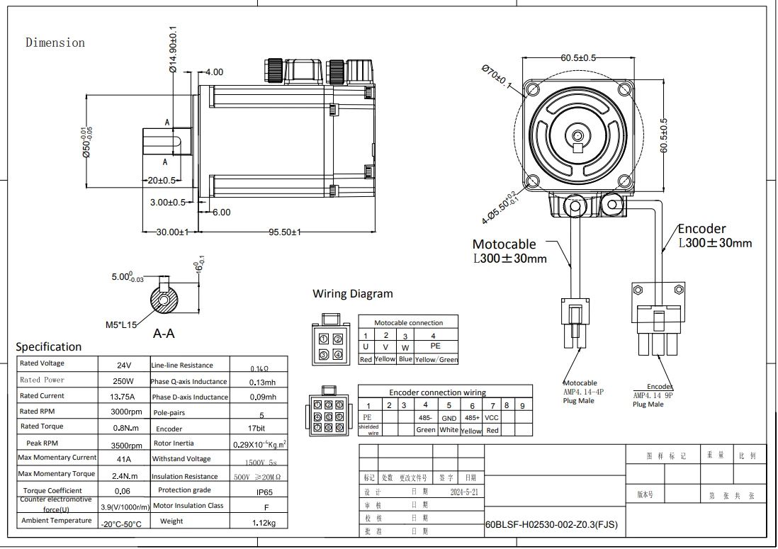

Hello! I am looking to run 4 industrial servo motors on any of the STM controllers (Any which can sustain such load, I am looking at STM32F7 series) in combination with TI DRV8323 BLDC motor driver. Now the issue here is these BLDC drivers require 6 PWM inputs to operate 3 half bridges (Just like any other BLDC driver) but with 4 motors it adds up to 24 PWM signals. I am confused if any of the STM can handle such extensive motor control application? Which one would be best suited for my application?
Any help is appreciated.
Stepper motor datasheet attached.
