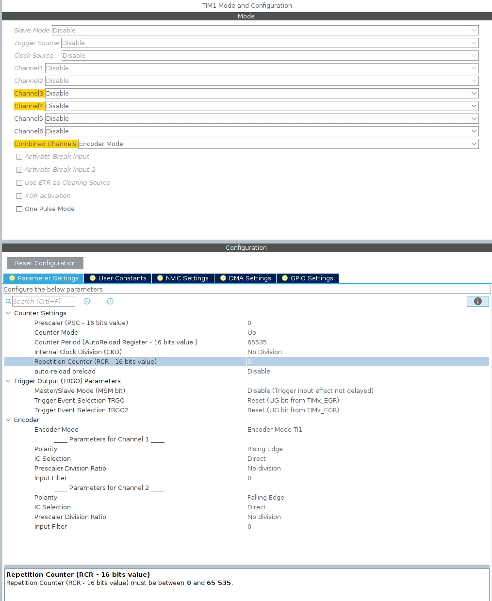

Increasing count range (CNT register) of16 Bit timer in encoder mode.
Due to some hardware restrictions I dont have any 32Bit timers available on my controller (STM32F7) at the moment. My application requires me to count upto 18bits, which is evidently surpassing the 16-bit count limit the register can handle and hence it overflows. As the header suggests, is there any way I could reliably increase my counting range (through HAL or external logic) which would not make me compromise on missing interrupts and get the job done?
Really appreciate all the help.

> , is there any way I could reliably increase my counting range which
No.
I suggest to move the encoder to one of the 32-bit counters and move the function which is now there to a 16-bit counter, and perhaps ask that question again with that other functionality.
Or use a small cheap 'F0/'G0 as a slave to extend on the counters.
