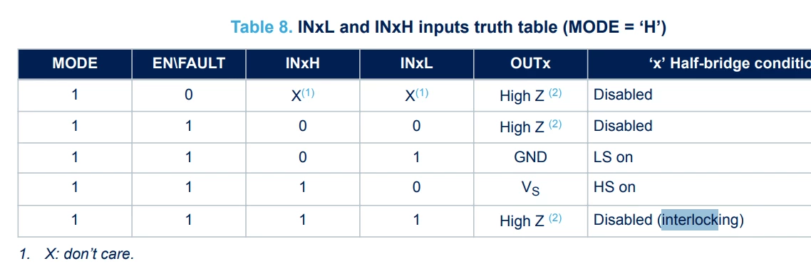

just from ds STSPIN830 :
So driving shoot-through is prevented by chip design.

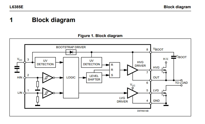

btw  >suggest anyway, any solution from ST
https://www.st.com/resource/en/datasheet/l6385e.pdf
L6385  has independent hi/lo side drivers.

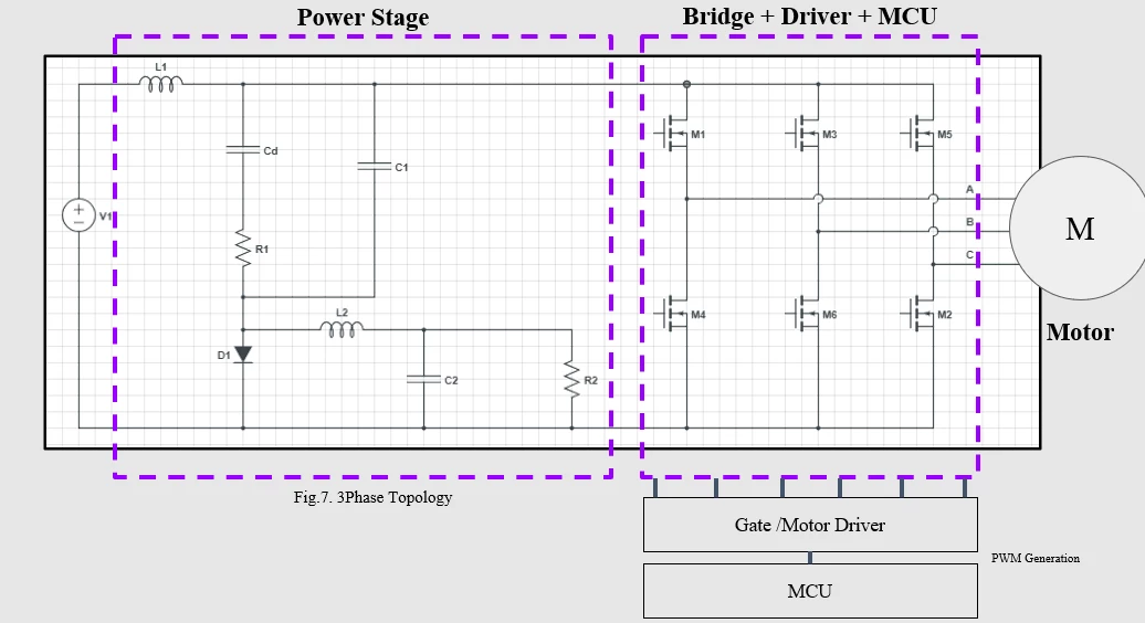

So the idea is as below circuit diagram
In this topology, the shoot-through interval is deliberately introduced as a control mode. During this interval, both the upper and lower devices of a phase leg are turned ON for a very short duration, while the current rise is limited by the input inductors and the DC-link energy storage network.
From my understanding, IHM16M1 provides six independent PWM inputs to the gate driver stage but has interlocking protection is there and as per your previous answer it cannot be override.

L6385 has independent hi/lo side drivers. yes, it does I think it is discontinued.

Ok, i see....    What should it do better than all the existing "standard" inverters (with deadtime) ?
> so I am thinking to tap out DC and AC from same circuit
Dont know any, sorry.
Sure no problem
btw
My last/actual inverter has about 50ns deadtime, switching 15kW output power at about 99% efficiency.
Oh okay, did you build it on your own?
Now I am thinking I have to go by building my own inverter so I can switch as I please.
If you know any documentations or any other resources for easy to build inverter that would be great
