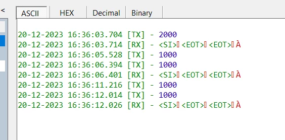

i have to set the speed taking from uart receive dma

can you please check if my code is correct i cannot see the rpm that i am passing through uart receive dma is been set to motor
could anyone please correct me

SRedd.5
Senior III
December 22, 2023
https://controllerstech.com/uart-receive-in-stm32/
This page may be useful for DMA receiving.
void HAL_UART_RxCpltCallback(UART_HandleTypeDef *huart)
 HAL_UART_Transmit(&huart2, rxbuffer, 1, 100);
 HAL_UART_Receive_DMA(&huart2, rxbuffer, 1);
setMotorSpeed(atoi(rxbuffer));
Your setMotorSpeed to be done after receiving the data.
The startMotor function is sufficient to call once.
Tesla DeLorean
Guru
December 22, 2023
Got single byte receive. Not able to receive a string.
You call a blocking function in the callback
One case you try to pass a variable when it wants a pointer.
HAL_UART_Transmit(&huart2, (uint8_t*)rxbuffer, 4, 100);
        HAL_UART_Receive_DMA(&huart2, (uint8_t*)rxbuffer, 4);
if (strncmp((const char*)rxbuffer, "start", sizeof("start") - 1) == 0)
flag = 1;
//MC_StartMotor1();
else if (strncmp((const char*)rxbuffer, "stop", sizeof("stop") - 1) == 0)
flag = 0;
//MC_StopMotor1();
else
rxbuffer[4] = '\0';
uint16_t rpmValue = atoi((char*)rxbuffer);
if (500 <= rpmValue && rpmValue <= 3000)
setMotorSpeed(rpmValue);
else
HAL_UART_Transmit(&huart2, (uint8_t*)"Invalid command or RPM value\r\n", 30, 100);
i have changed my code can you please refer it again and tell me modifications @Tesla DeLorean @SRedd.5
