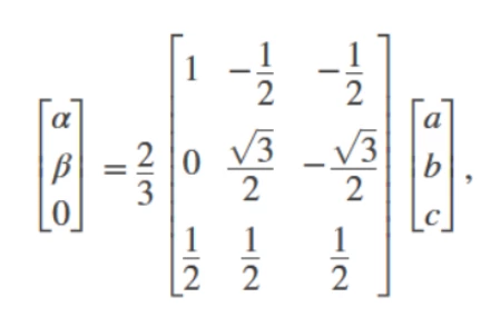

I am analyzing the FOC algorithm using motor control workbench 6.10.
During the analysis of the FOC algorithm, I do not understand the MCM_Clarke function part.
In the case of Clarke transformation I know, it is an algorithm that converts three axes into two axes. However, at mcm, it seems to convert two axes into two axes as shown below.
 alpha = a
 beta = -(2*b+a)/sqrt(3)
0693W00000aHiauQAC.pngMaybe I can get some help?

Hello gkim.19 (Community Member),
The answer relies on an additional equation : a + b + c = 0, which we use to remove any c value from our results to depend only on a and b values. This is why you might at first think MCM_Clarke converts two axes into two axes and not three axes into two axes.
Developing my point, we start with :

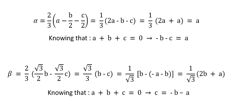

0693W00000aHioFQAS.pngwhich gives :
0693W00000aHj0JQAS.pngWe find the values given in MCM_Clarke function.
Hoping this will help,

Thank you.
I thought about the above conversion for a long time.
But, I didn't think of going crazy with the rule of a+b+c=0 and substituting it for this formula.
Your a+b+c=0 core solved everything.
I'm much obliged to you for your help
