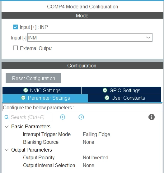

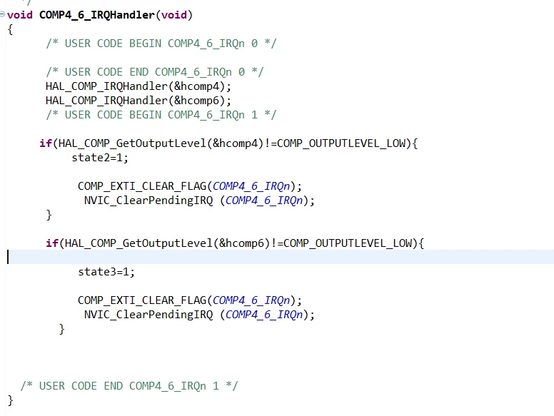

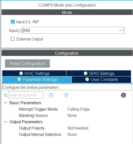

I can't distinguish comp4 and comp 6 in interrupt
  • July 25, 2022
  • 0 replies
  • 640 views
hello everyone,
ı am trying BLDC motor driver with stm32f302R8 but ı having a problem with comp4 and comp6 interrupt. when ı input COMP4_6_IRQHandler, ı try to distinguish comp4 and comp6 interrupt. but both comp4 with comp6 be activating. ı can't find solutions. please help me.0693W00000QM1slQAD.png0693W00000QM1sqQAD.png0693W00000QM1sgQAD.png
