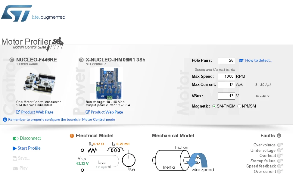

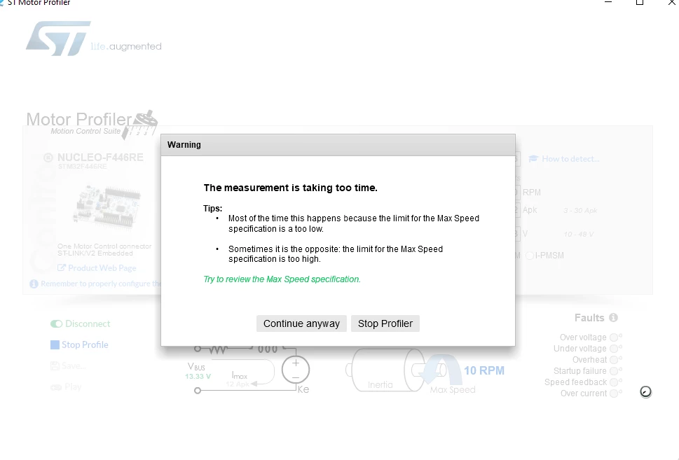

I am using X-NUCLEO-IHM08M1 NUCLEO-F446RE Motor Profiler 5.4.8 motor>>48v 600w not run
0693W00000Un8ovQAB.pngI want you to help explain and help fix it.0693W00000Un8pUQAR.pngMotor 48 volts, 600 watts, number of pairs of poles 52/2=26
or the motor is too big, please reply, thank you very much.

(please check if you well done all requested modification for FOC and MP (Motor Profiler) support. Not all motors can be tuned by MP a specially if motor do not fit to Power Stage parameters or if it not tested at nominal motor conditions please check od modify filled/used speed, current, voltage)

There is a design fault on the IHM08M1 (at least on the 3 units I have) where the switch-mode converter does not start when Vbus is greater than about 12V. The output from this switch-mode drives the output driver enable signal, so there is not FET drive when Vbus is more than 12V, hence the test never works. This may not be the cause of your problem, but it is a good place to start.

I ran into that problem.Troubleshooting is very difficult.Doesn't work as intended
jartim
November 16, 2022
I tried to fault-find the circuit but it is almost impossible without any of the original design information. I ended up having to run my motor at 12V only during development then I will move to a custom board for the final product.
