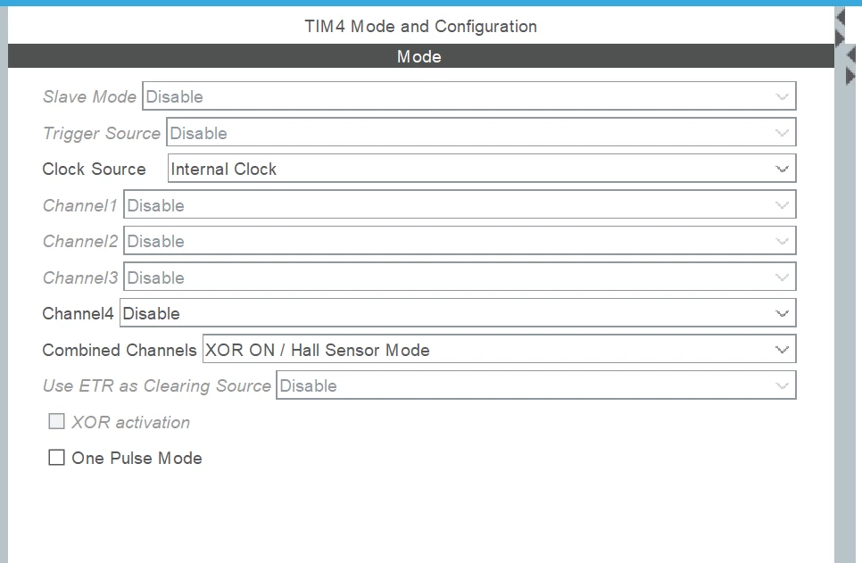

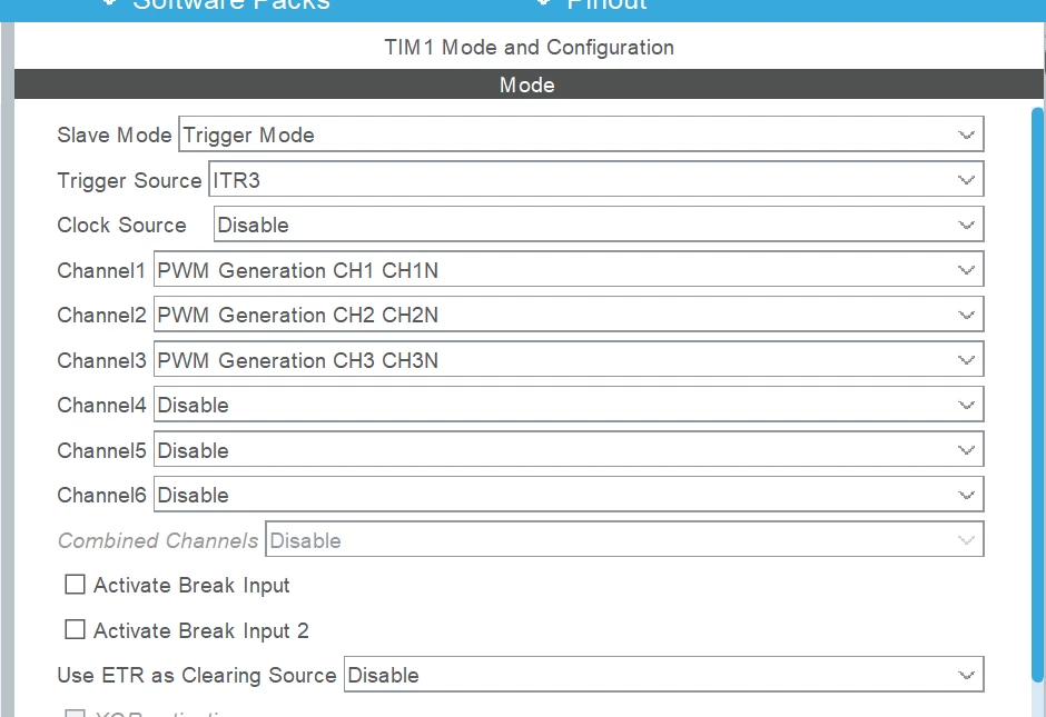

I am using HALL sensor mode on Tim4 and PWM generation with TIM1. I don't understand now how do i read hall sensor status .
HAL_TIMEx_ConfigCommutEvent(&htim1, TIM_TS_ITR3, TIM_COMMUTATION_TRGI);
// HAL_TIM_IC_Start(&htim4, TIM_CHANNEL_2);
   HAL_TIMEx_HallSensor_Start_IT(&htim4);
here is my config setting:
0693W00000Hqc4hQAB.png0693W00000Hqc56QAB.pngbelow is my capturecall back function.

Dear @Tejashree​ ,
It seems that you do not use the x-cube-mcsdk available here.
This is the best help we can provide ! Using the MC_SDK, you will end-up with a fully functional project with hall sensors if you selected them. Up to you to analyze the code and understand how did we do.
