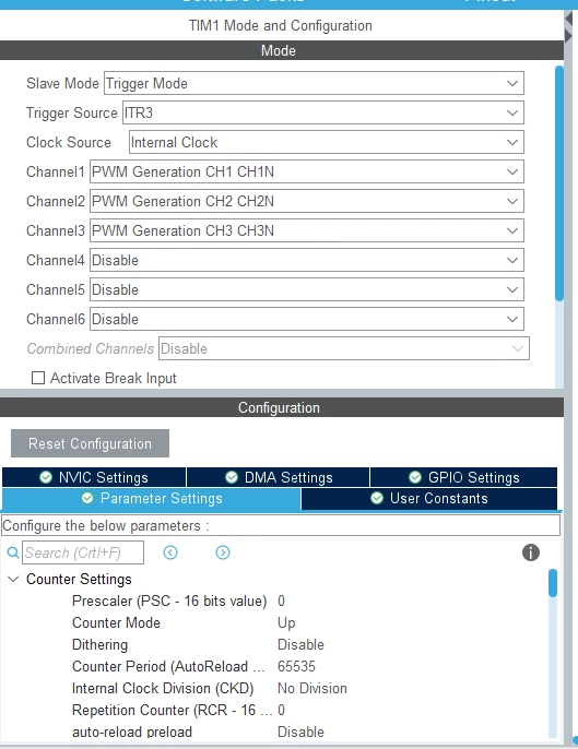

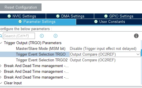

I am using advance timer 1 for pwm generation and hall sensor on timer 4.Internal trigger is not working in this case.

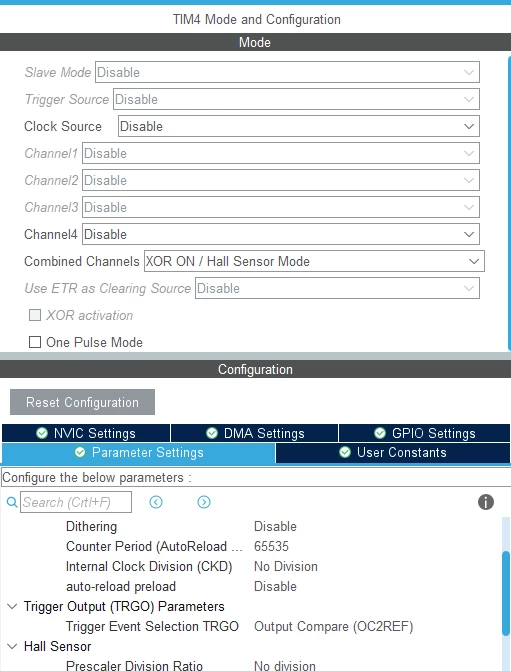

I am trying to use combined channel :XOR/HALL sensor on timer 4:
0693W00000GYNmKQAX.pngand trigger mode on timer 1 to trigger pwm:
0693W00000GYNisQAH.png0693W00000GYNnIQAX.pngI don't understand why my trigger is not working.I see a constant pwm on the line

The first picture gives the impression that timer 4 is not enabled.
You cannot trust CubeMX 100%, it's mostly a starting point, so always find a way to check the register settings (UART).
Tejashree
TejashreeAuthor
I am using STM32G431CB, which has dedicated pins for hall sensor.So when ever i select XOR/HALL sensor setting.The channel assignment is done automatically and so i cannot change any settings.
I believe LCE is saying that "Clock source: Disable" indicates the timer isn't running. Probably this should be set to internal.
