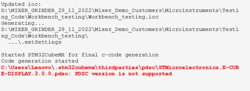

I am generating code through Motor Control Workbench (X-CUBE-MCSDK) but this error suddenly popping up during code generation. Please assist.

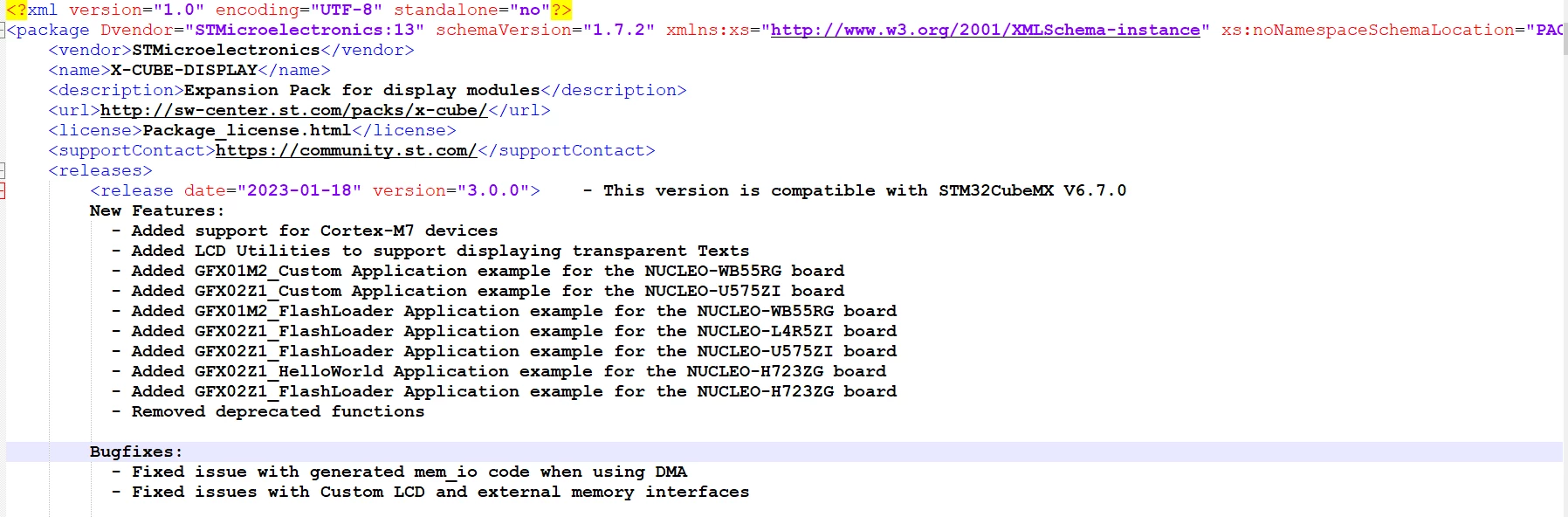

This is the actual file in the system :

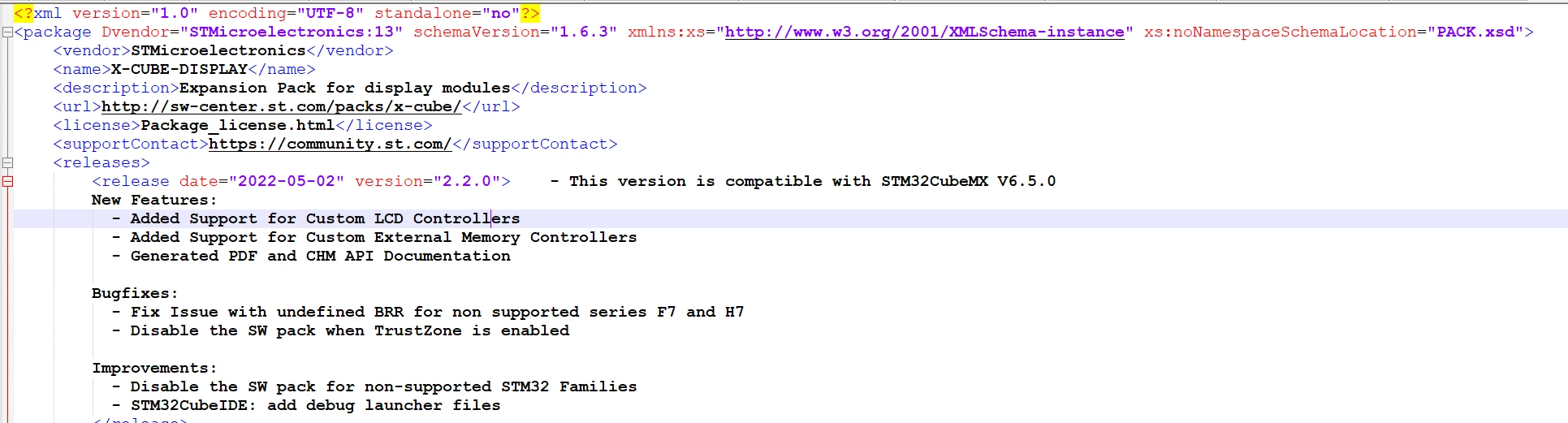

open it with your test editor and show us the version.
This is mine.
Goes without saying, did you have a very old cubeMX installation or did you do something funky with it?
hit me up in https://www.linkedin.com/in/javiermuñoz/
Kunal
KunalAuthor
got it i am using an old version of Cube MX version 6.2.0, will upgrade it. Thanks for the support
