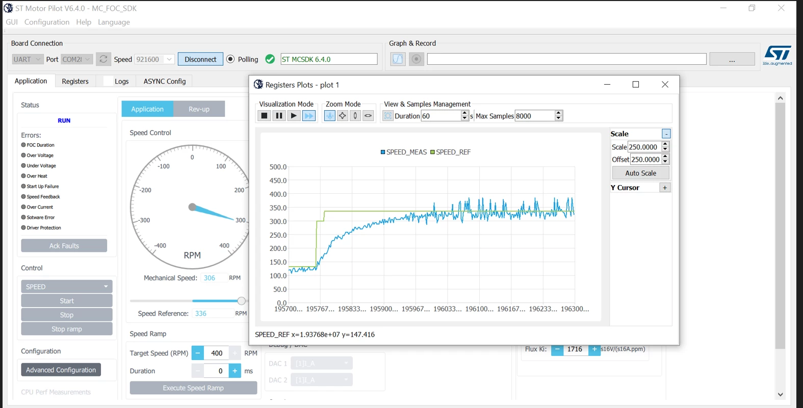

Hi Everyone,
We are using an STM32F401RE Nucleo board with the IHM16M1 power board, running a sensorless FOC algorithm generated using ST Motor Control Workbench. The motor parameters were averaged over several runs using ST Motor Profiler, and the control is implemented in 3-shunt topology.
Observed Issues:
  1. Humming noise becomes audible and increases as RPM increases.
    • This is more prominent at higher speeds.
    • At low RPM, noise is tolerable but increases as speed ramps up.
      Speed graphSpeed graph
      Modifications done in Motor Control Workbench to mitigate issues:
      • Increased Kp divider to reduce aggressive control at low speeds (reduces noise at low RPM but not high RPM).
      • Reduced Ki to prevent instability.
      • Reduced Observer G2 gain to prevent speed feedback faults in Motor Pilot.
  2. PWM Mode Testing:
    • Switching from center-aligned to discontinuous PWM seems to delay the onset of the humming noise slightly, but noise still eventually appears at high RPM.
Is there a recommended strategy to suppress audible noise in the high-speed region for sensorless FOC?
       Any suggestions or tuning tips from others who used the IHM16M1 + F401RE + sensorless FOC combination would be highly appreciated.

Hello @Mani2,
Have you verified whether the PWM frequency affects the occurrence of this noise?
If you agree with the answer, please accept it by clicking on 'Best answer'.Best regards.GMA
Mani2Author
Aug 26, 2025 8:01 AM UTC
Hello @GMA,
We checked with 20 kHz, 30 kHz, and 50 kHz, but the same humming noise was observed.
Best regards,
Manikanta

Ozone
Principal
Aug 26, 2025 12:13 PM UTC
I suspect this is the mechanical resonance of your motor. The closer you get, the more energy is tranferred into vibrations.
You could try to move the resonance point by mounting the motor to a solid (and heavy) frame, or dampen it (mount with rubber buffers).
Or try another motor.
