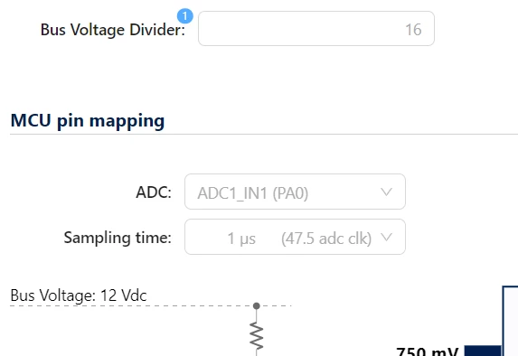

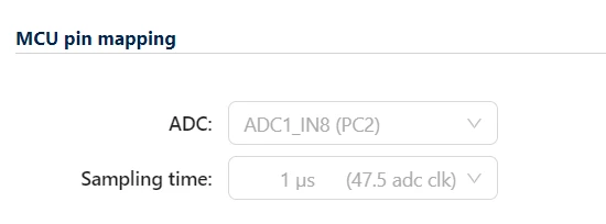

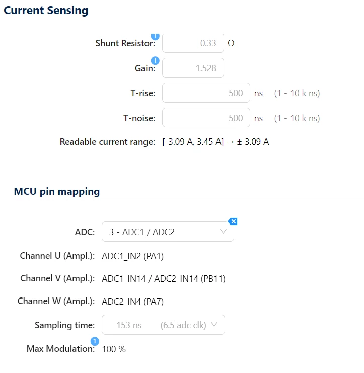

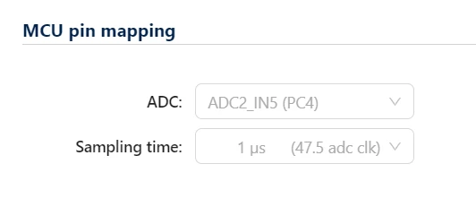

Zek_De
Zek_DeAuthor
Senior
Jan 2, 2025 5:03 PM UTC
according to workbench also I can use these, right?
EVALSTDRIVE101
NUCLEO-IHM09M2
B-G473E-ZEST1S
Because I can select these 3 in workbench application.
