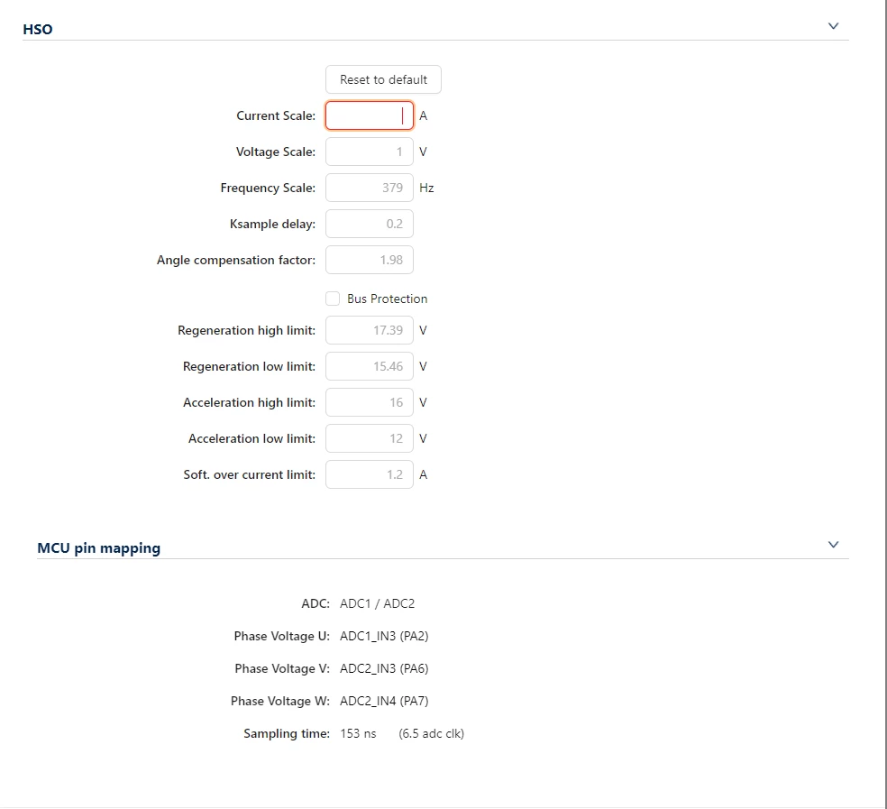

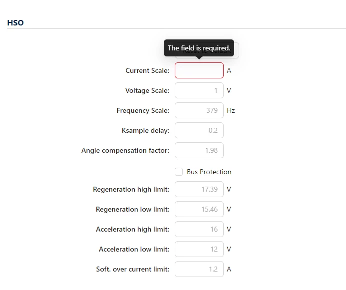

I am having trouble generating an HSO based project.  I have already confirmed the board works with “Observer+PLL”.  When switching to HSO I am able to select it in the drop down, at which point it:
1. Resets my current sense gain (should be 50), I have no issues replacing this value.
2.  Under Speed Sensing I am provided with an empty Current Scale box, which is a “required field” however upon entering a value it remains red and tells me I cannot enter a value, as “no value is allowed”.
Is this a bug or have I configured something incorrectly?  It also seems odd that the current gain setting is cleared, although I can edit that without issue.

Hello @reesed13,
The parameter offsetNetworkAttenuation must not be set to 0 and should be computed according to the amplification chain. For more details, refer to the Motor Control Boards Description wiki page.
If you agree with the answer, please accept it by clicking on 'Best answer'.Best regards.GMA

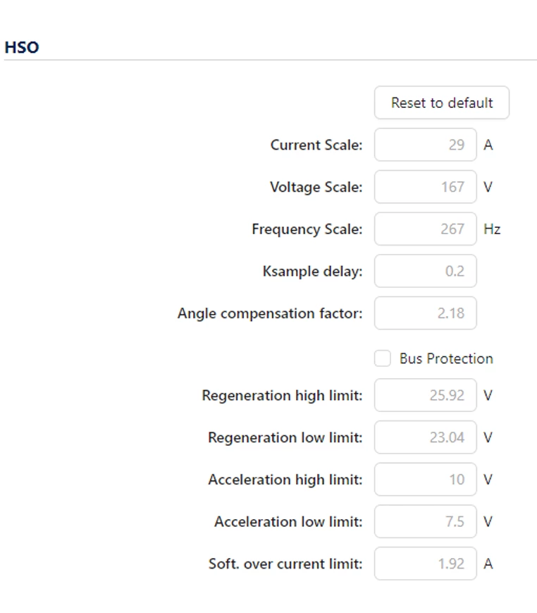

Jul 30, 2026 2:53 AM UTC
Please refer to the setting below, it seems the default value is 29A for current scale

Jul 30, 2026 8:00 AM UTC
Hello ​@reesed13,
It seems that the “Current Scale” parameter is not updated according to the gain or shunt parameters.
Did you try by setting the current sense gain in the json board description files?
If you leave the mouse cursor over the “Current Scale” window, a popup will appear with the expected values.
reesed13Author
Jul 30, 2026 11:01 AM UTC
​@GMA
Re-generating it in Motor Control Workbench (6.4.2) does not seem to fix the problem.  When hovering the field, there is no default value provided.  The tip/info popup changes to the second image.  What I type in the box does not seem to have any effect, and it prevents me from generating the project file.
My board JSON file correctly describes the OpAmpGain value as 50, but I included it below if needed.  Additionally a voltage scale of 1V did not really make sense to me, but at least I can change that without any issues.

Aug 27, 2026 7:34 AM UTC
yes,The parameter offsetNetworkAttenuation must not be set to 0 ,but 1.
