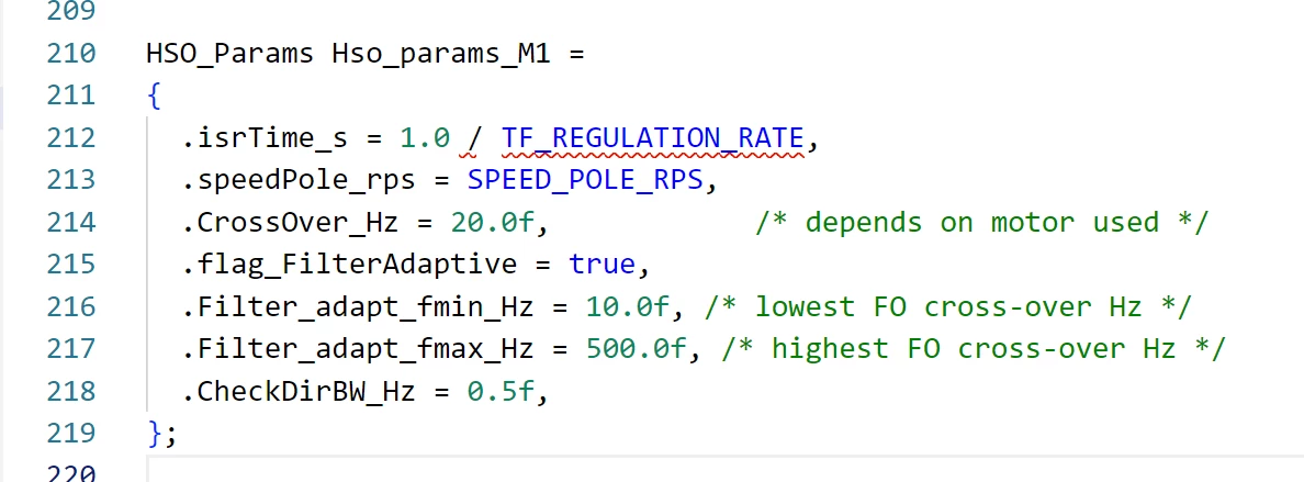

In this regard, after reviewing the configuration parameters in the firmware, I am wondering how the following are calculated:
SPEED_POLE_RPS doesn’t seem to change as I edit the motor parameters in Motor Workbench. Which parameters is it based on?
Regarding CrossOver_Hz, the comment indicates that it depends on the motor used, but I don’t see it change even when I modify motor settings in Motor Workbench.

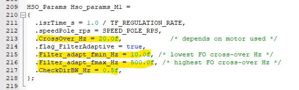

I encountered the same problem mentioned above. After modifying the motor parameters using MC Workbench and generating new code, when I compared the new code with the old one, I found that the parameter configuration for the structure named Hso_params_M1 does not change according to the motor configuration parameters. However, the comments within this structure state that this parameter needs to be adjusted based on the motor. Could you please explain in general how this adjustment should be made?

CrossOver_Hz is a parameter that does not need to be changed by the user. Only the maximum and minimum values are useful to tune, but the default ones are already sufficient for the large majority of use cases. It is true that the code documentation is confusing, thank you for your feedback.

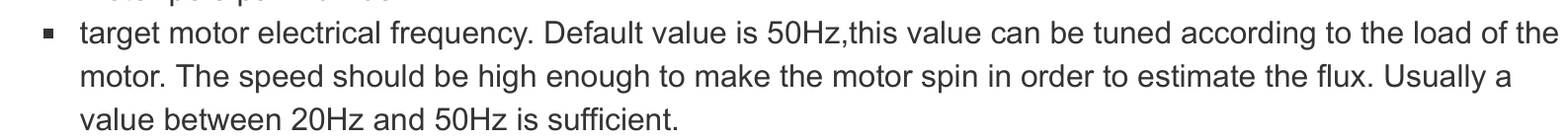

  1. During profiling, I understand that the internal logic is similar to the OpenLoopCurrent mode. It cannot bring the motor to speeds above 100 Hz. Additionally, when the RS and LS learning is complete, the learned resistance values are as follows. In my view, since the values of the motor’s parameters are relatively small, deviations are normal. I would like to know if the frequency during profiling can exceed 100 Hz? How should I modify it?
The following text is from the HSO_STARTUP_GUIDE."

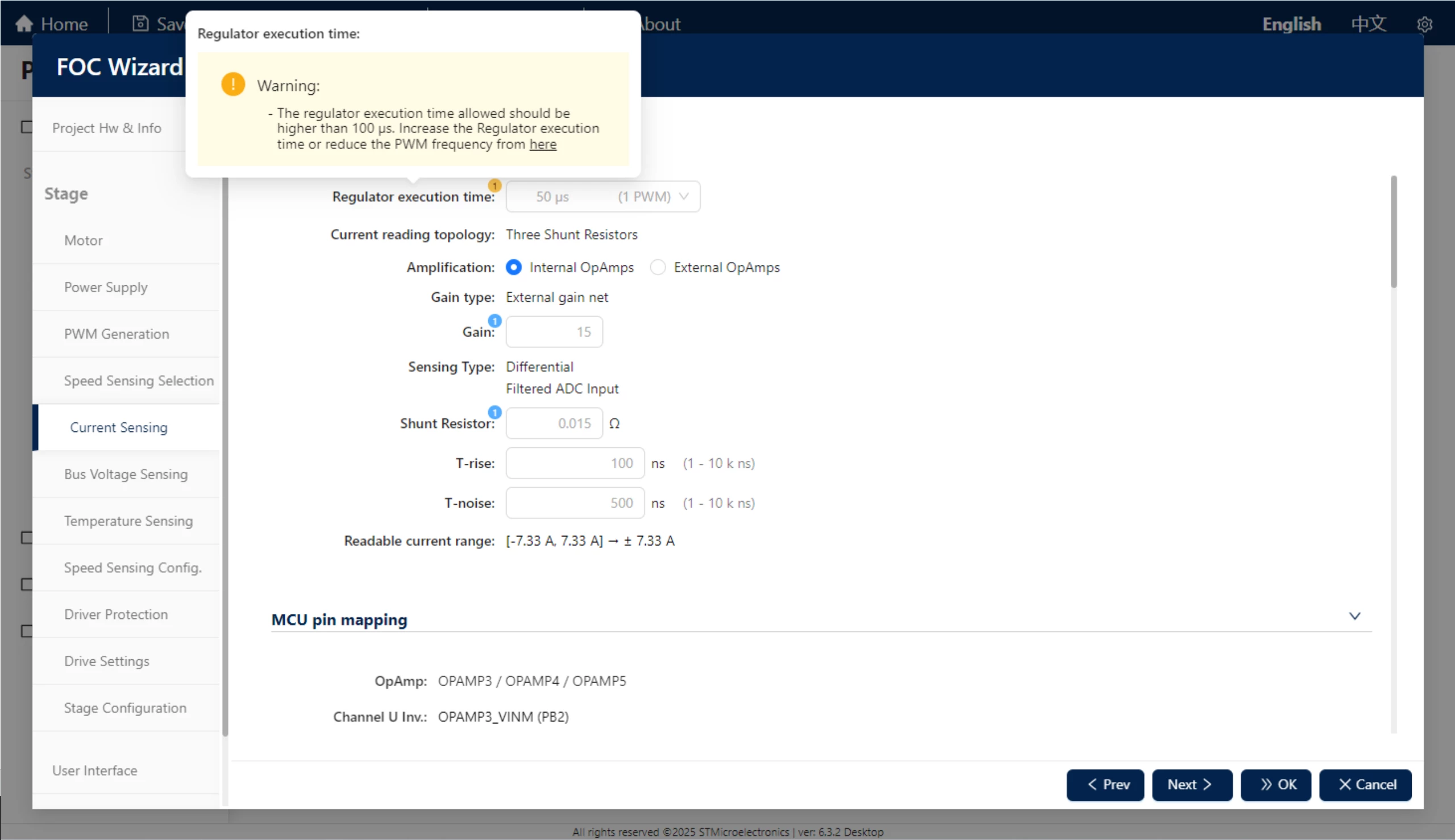

  3. In the MC Workbench 6.3.2, the "Regulator execution time" prompt suggests that it should be greater than 100us. I don't quite understand this. I have tested that the high-frequency task time is about 30us, which means the PWM frequency should be able to reach 33kHz, performing one algorithm calculation per PWM cycle. However, if the regulator execution time needs to be greater than 100us, this implies that the algorithm calculation frequency should be less than 10,000Hz. Would this have a significant impact on the bandwidth of the current loop? I would like to ask, what is the maximum frequency at which the HSO algorithm can reliably operate in practice?propu_2-1736823719012.png

The speed at which the Profiler makes the motor run is only relevant for Flux estimation, not Rs nor Ls.

The WorkBench value is purely indicative, you can try with lower periods and see how it goes. We have no definite known speed at which the HSO is not able to keep up anymore.

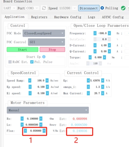

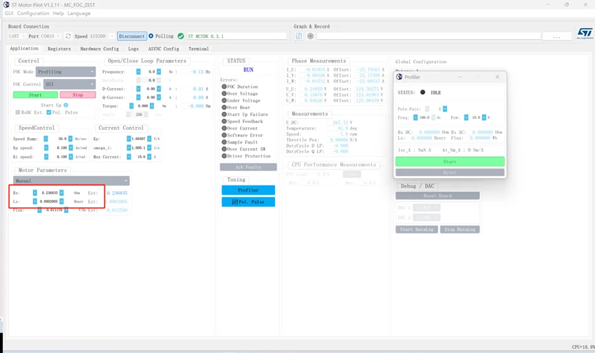

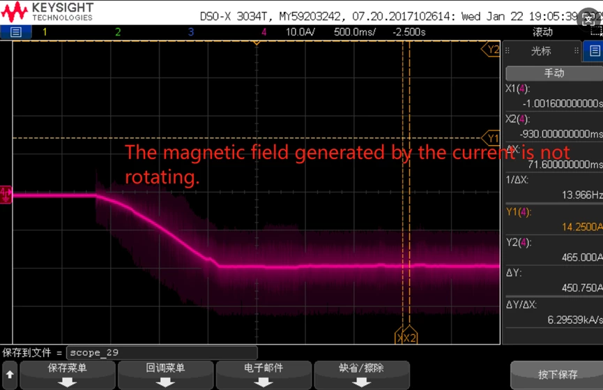

In the image below, the measured resistance Rs of the motor by RLC device at the position marked by the red box is 0.19 ohms. When I directly set the value to 0.19 ohms in the code and use the default Pol.pulse method, the motor has a very high chance of not rotating. However, when I manually set Rs to 0.16 ohms, I found that the motor has never failed to turn。

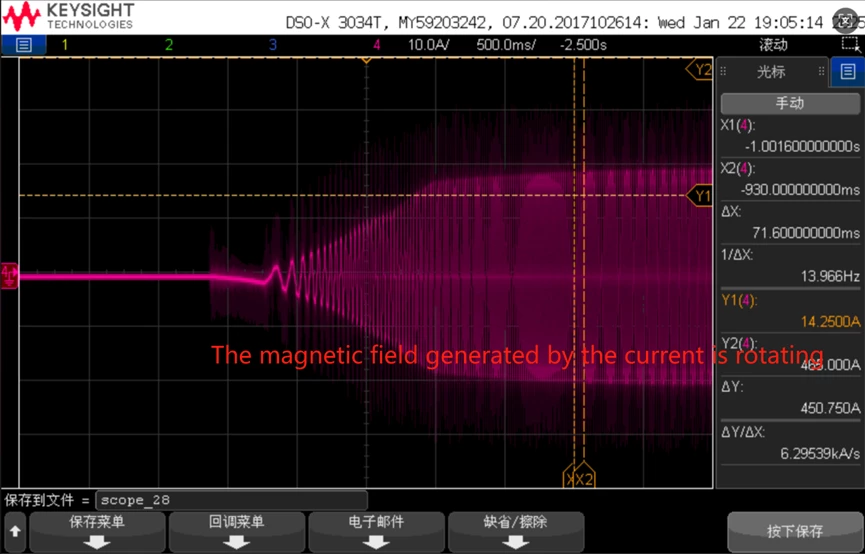

Comparing the current waveform on the oscilloscope, the image below shows the current waveform of the motor with a resistance of 0.19 ohms when the startup fails. The current stabilizes in one direction and does not generate a rotating magnetic field。

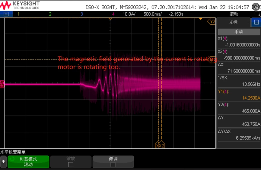

When I reduced the resistance to 0.001 ohms, I found that the output motor current was always rotating, and its amplitude kept increasing. The motor did not rotate. I understand that the increasing amplitude is due to the speed control loop, which controls the speed, and the output Q-axis current is continuously increasing。
When I tried setting the D-axis current to 4A while still using a resistance of 0.001 ohms, the motor could be dragged up and successfully performed the  closed-speed-loop control。

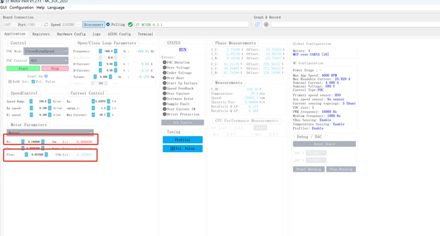

  1. After the above verification, I am very confused and do not understand how to use the HSO observer to create a reliable startup product. Is there something wrong with my configuration? Why does the resistance have such an effect

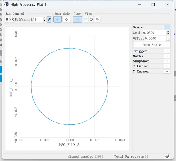

  2. Additionally, when running stably at 1000Hz, for the position marked as 1 in the image below, 0.058 is the magnetic flux value I calculated. However, the estimated value at position marked as 2 is 0.24. Does this indicate that the magnetic flux value I set is incorrect?propu_4-1737547253776.png

As propu described, in MC Workbench 6.3.2, the "Regulator execution time" prompt suggests it should be greater than 105 µs with 4 PWM for my project at FPWM = 38 kHz.
If I reduce it to 1 PWM, I get an FOC duration fault.
