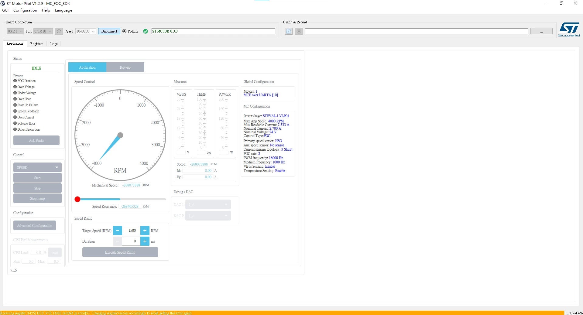

Dear All,
My platform as list:
Control Board: B-G473E-ZEST1S
Power Board:  STEVAL-LVLP01
Motor: B-MOTOR-PMSMA1
Platform: MCSDC 6.3.0,  (I attached my Workbench configuration file as follow)
CubeIDE: 1.15.1

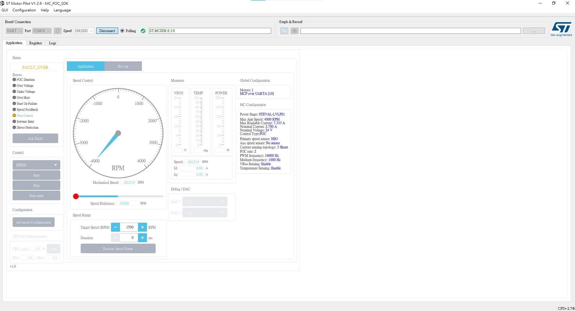

When I try to evaluate the HSO, the Motor pilot appear in weird value.
The speed reference and mechanical speed is wrong.
Also, there are a orange waring, "Access Register of  Bus Voltage resulted in error" on the buttom.
Once I start the contol, it will occurs "Over Current Fault"
Has anyone encountered a similar issue? How can it be resolved?

    In fact you are trying to use STOPLL/Cordic UI with a HSO firmware.
    Please load the MC_FOC_ZEST.qml UI instead.
    Thanks
