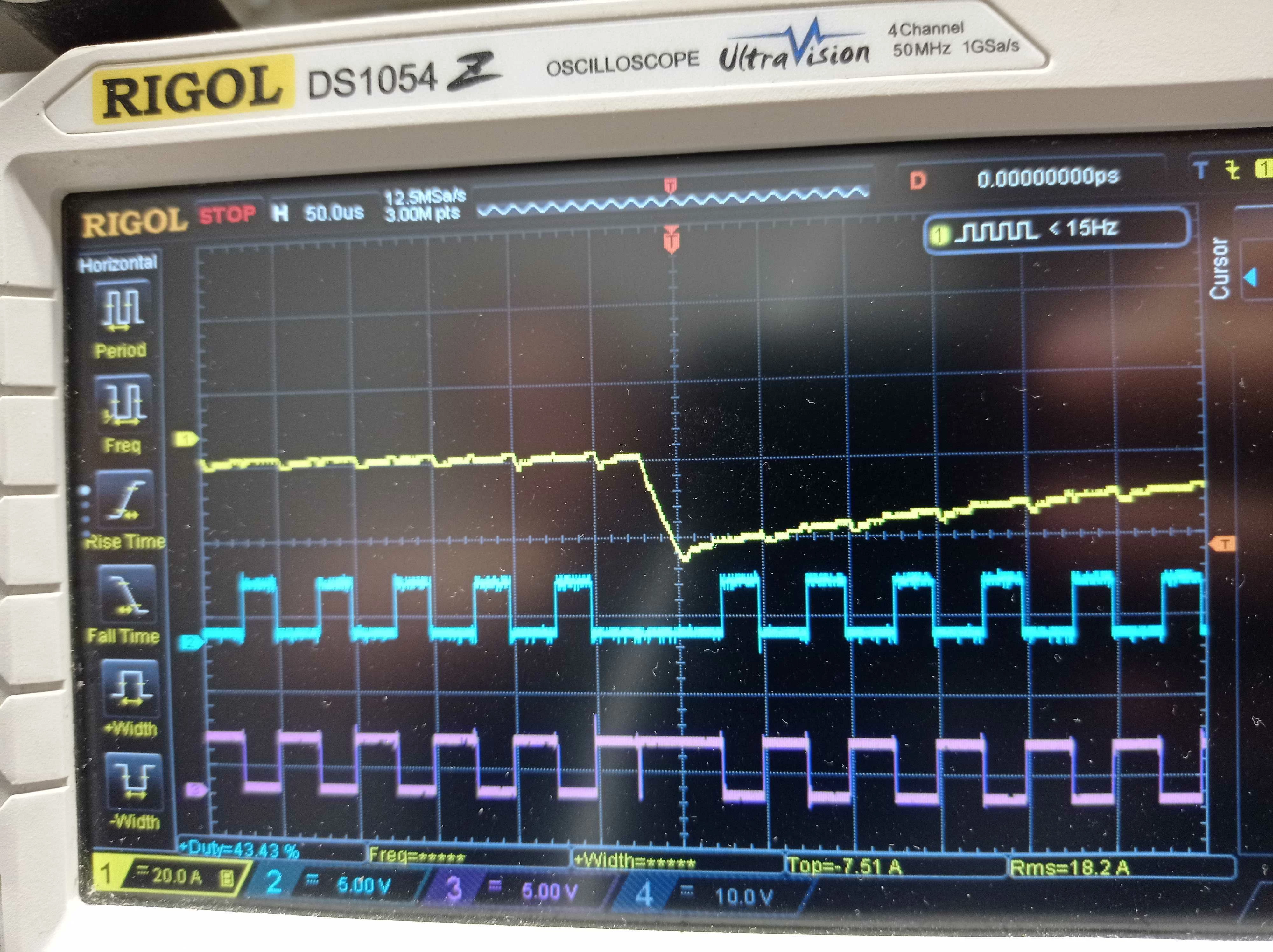

I am working on BLDC driver based on STM32. I am using HRTIM to generate 3 complimentary PWMs at 20Khz in up-down counting mode. Every now and then, a single pulse of the PWM is wrong, like it would have 100% duty cycle. The issue is non periodic (seems to happen in random time intervals, ranging from ~0.1 Hz to ~10Hz), and happens on all channales of the HRTIM. It results in a loud audible noise from the motor.
On the image below you can see an oscilloscope screen of the event. Top curve is current on the one of the motor phases, the lower two are complimentary PWMs (on the STM side, before the mosfet driver). I am using 20 kHz control loop for updating the PWMs duty cycle with normalisation in place to make sure i never accidentally write illegal value to the register. I have tried both with Reload Enabled and Disabled. I have also tied to lower the control loop frequency to 12 kHz and 5 kHz but the issue persisted.

I have also tried with my control algorithm turned off (just throwing raw sine waves to the PWMs) and the issue persists.
I suspect the issue is somehow linked with writing new values to HRTIM registers. This is how i do it:

Tomas DRESLER
Dear Maty,
I suspect that your update comes in "wrong" time, because HRTIM PWM doesn't react on comparison with the values, but on exact match between the CMPx register and the counter.
I recommend to turn on preload on all registers and automatic update on reload. This will guarantee synchronous update of all registers without risk of being ignored and causing non-reaction on the channel.

JMaty.1AuthorBest answer
Hi Thomas.
I think I've solved my problem. The solution was to enable preload, set update on repetition event (so that updates happen when counter reaches 0), and to switch CMP unit I used from CMP1 to CMP2 . As described in 27.3.12 section of the Reference Manual, CMP1 and CMP3 feature no-latency update, that caused the issue.
