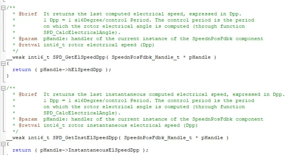

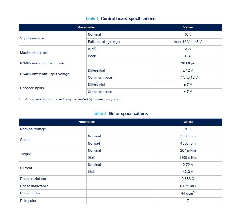

Hello everyone, How to get current speed of motor,useing  speed_pos_fdbk.c  ,i try to use the functions in fig2 SPD_GetElSpeedDpp but I don't Know how to get the control Period ,It is written in the comments to use the SPD_CalcElectricalAngle ,but i can't find it 。or is there another way to get current speed of motor。
Thank you very much
0693W00000aH8yvQAC.jpg​ (fig1)​ motor Specification

If your point is still relevant, all of the APIs are defined in the mc_api.[c,h] file.
To obtain the current average speed of the motor, use the following API: MC_GetMecSpeedAverageMotor1().
This API returns the most recent calculated average mechanical rotor speed, expressed in the unit specified by #SPEED_UNIT.
For instance, if RPM is the chosen unit, SPEED_UNIT should be defined as 60.
If you agree with my answer, please accept it by clicking on 'Accept as solution'.""
