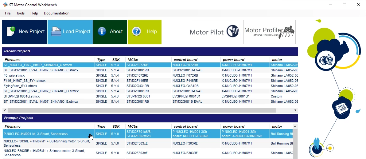

Using IHM001 kit with F302R8 and IHM07M1 boards and bullseye motor. Have found motor info using the motor profiler. From the MC workbench, generated code and then in the main.c file done simple start stop sequence (as shown in the step by step guide wiki.st.com/stm32mcu/wiki/STM32StepByStep:Getting_started_with_Motor_Control). Motor starts/stops around 3 times, then MC workbench shows speed feedback fault error and won't restart. I have looked in the motor control FAQ and tried some changes suggested but no luck. As this is part of a motor kit, I was wondering if there are any specific extra settings I need to change, eg. in start up ramp?

Could you try the provided example as comparison point?
0693W00000QL5DkQAL.png Best regards.
