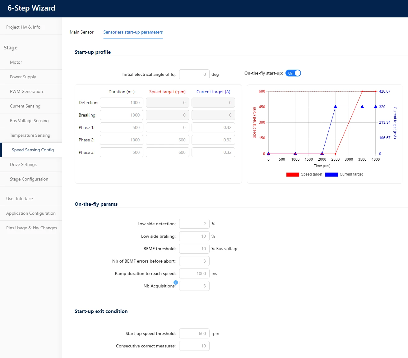

Fabrice LOUBEYRE
July 23, 2025
Hi TKara.2,
if you are using the MCSDK6.4.0, you will find the "On The FLy" feature designed for the 6step algorithm. This will allow your motor to restart from a spinning state with no revup phase, as described into the "Six-step Firmware Algorithm" user manual (chapter 5.1.6 Rev-up component and On-the-fly start-up) embedded into the MCSDK Workbench tool.
Please refer to User Manual documentation available through: "Workbench tool">About>Documentations>Documentation>"User manual" tab>"Six-step Firmware Algorithm" link
To enable the feature, you must set the On-the-fly start-up bit into the MCSDK6.4.0 Workbench, and regenerate the project.
Best regards.
Fabrice
