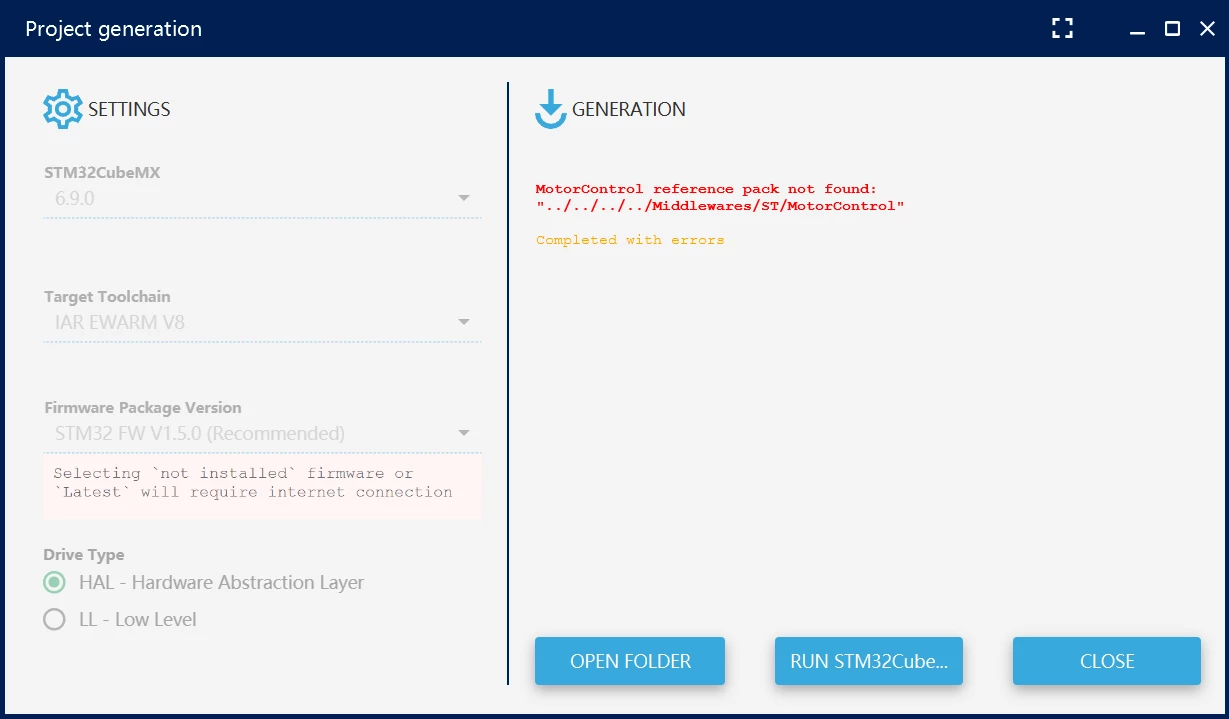

How to solve "MotorControl reference pack not found" in MotorControl Workbench 5.4.8
When I want to generate a project, this error stops me.
Is there any installation steps that I skiped?

    Hello @BurnNavy ,
    I proposed a solution in this post: Solved: MotorControl reference pack not found: "../../../.... - STMicroelectronics Community
    but i recommend you to use version 6.2 of the MCSDK on which the B-G431B-ESC1 board is supported.
    Regards

    By the way, the development board is B-G431B-ESC1. There is the project created, however, I can't open most of the files.
    Should I change to MCSDK 6.2.0?

    Hello @Zied b.
    Thanks for your solution.
    Honestly, I don't understand the post. Fourtunately, "generation" works after using 6.2.0.
