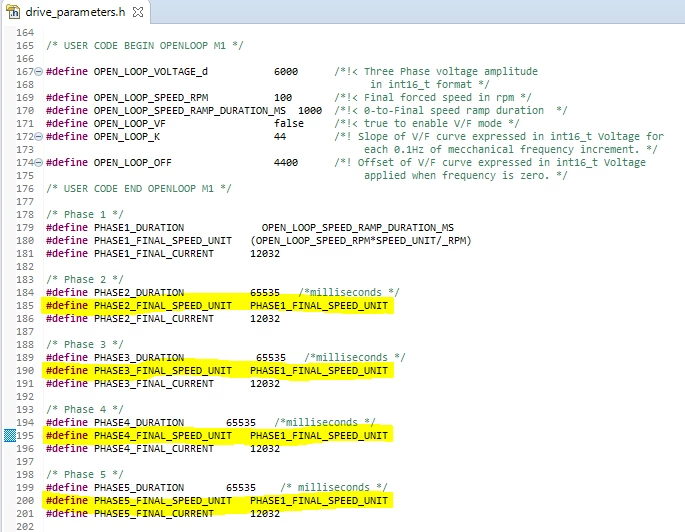

I think you have this issue due to the use of an old version of the MC Workbench.
The issue is in drive_parameters.h, be sure to have these declarations:

Hello KKrag.1,
To run a motor in open loop, as you said you need to set "OPEN_LOOP_FOC" to true in the IOC file and generate the project with STM32CubeMx.
In your project, you can find:
  • in drive_parameters.h: open loop parameters
  • in mc_task.c, in the medium frequency task, at START state, the open loop algorithm is performed
To control your application, you can use functions in mc_api.c.
For example, to start your motor, you can call MC_StartMotor1(void).

When I change the Open_Loop_FOC to "true", I get compile time errors:
mc_config.c:135:67: error: 'PHASE2_FINAL_SPEED_UNIT' undeclared here (not in a function); did you mean 'PHASE1_FINAL_SPEED_UNIT'?
                             {(uint16_t)PHASE2_DURATION,(int16_t)(PHASE2_FINAL_SPEED_UNIT),(int16_t)PHASE2_FINAL_CURRENT,&RevUpControlM1.ParamsData[2]},
mc_config.c:136:67: error: 'PHASE3_FINAL_SPEED_UNIT' undeclared here (not in a function); did you mean 'PHASE2_FINAL_SPEED_UNIT'?
                             {(uint16_t)PHASE3_DURATION,(int16_t)(PHASE3_FINAL_SPEED_UNIT),(int16_t)PHASE3_FINAL_CURRENT,&RevUpControlM1.ParamsData[3]},
mc_config.c:137:67: error: 'PHASE4_FINAL_SPEED_UNIT' undeclared here (not in a function); did you mean 'PHASE3_FINAL_SPEED_UNIT'?
                             {(uint16_t)PHASE4_DURATION,(int16_t)(PHASE4_FINAL_SPEED_UNIT),(int16_t)PHASE4_FINAL_CURRENT,&RevUpControlM1.ParamsData[4]},
Any hint to how to avoid those?

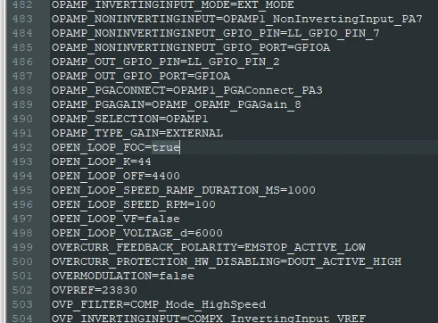

Looking for this OPEN_LOOP_FOC, but not finding it. Runing 5.y.4
ALedi.1
July 20, 2022
you need to open the .ioc file in editor and search for OPEN_LOOP_FOC 0693W00000QLc9lQAD.png
SpinKernel
July 20, 2022
Thank you! I did find this and have it functioning. Curious why this isn't in the gui?
