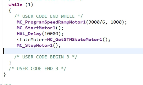

How to run a pmsm using C-functions of mc_api.c?
I tried to run my motor (PMSM) bit it doesn't run.
I used like reference the document:
https://www.st.com/content/ccc/resource/technical/document/user_manual/group1/48/e6/91/f4/66/ea/48/a1/DM00490980/files/DM00490980.pdf/jcr:content/translations/en.DM00490980.pdf
I use:
  • STEVAL ESC001V1
  • Motor Control Workbench 5.4.8
  • Motor Profiler 5.4.8
  • STM32CubeIDE 1.8.0
  • STM32CubeMX
Firstly, I generated a code in Motor Control Workbech. In this code, I wrote the next code to run my motor but it didn't work. I don't know why because it didn't have any errors.

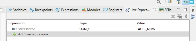

At the same time, I used "MC_GetSTMStateMotor1();" which showed me that I have 2 faults.
I need help pls!!
Kind regards
My code:

Currocan see the state motor here:

If your point is still pertinent, if motor state reports FAULT state, you can use MC_GetOccurredFaultsMotor1() api to get the error ID (definitions are in mc_type.h file). According to this error ID, please have a look to our FAQ page in order to handle it.
