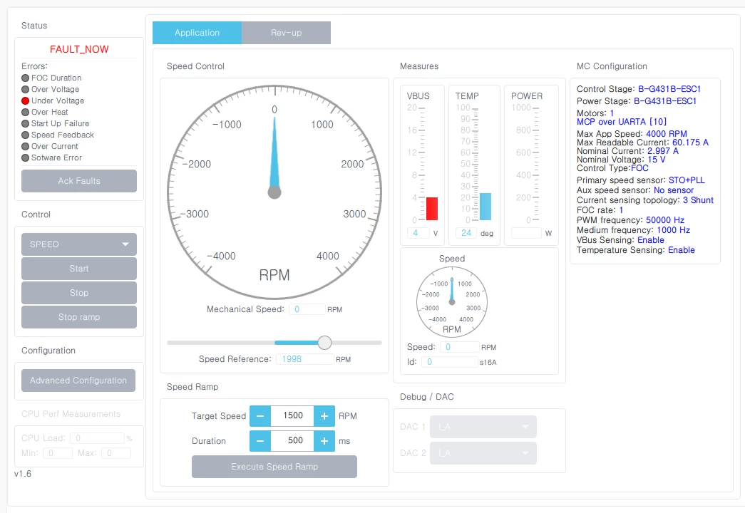

I am trying to run a BLDC motor using Motor Pilot 6.1.1 with B-G431B-ESC1.
Here's my process.
  1. profile motor using motor profiler
  2. generate code using mcworkbench 6.1.1 with the values obtained from the profiler
  3. using CubeIDE, open generated project and click debug + play
  4. open motor pilot -> Load UI -> MC_FOC_SDK.qml
  5. connect board (successful, image below)
  6. connect power supply
  7. set ramp target = 1500rpm, 500ms
  8. set speed reference = 2000rpm
  9. click start
when in IDLE mode, the motor is making a wierd knocking noise, at a rate of 1 sec.
and when I press start, the status change to START, the motor(or the board; I'm not sure) makes beep noise once(for about 0.5s) and the state returns to IDLE.
Please help. Thanks.
JKong.3
JKong.3Best answer
May 23, 2023
as it turns out my motor is broken. no need for an answer
