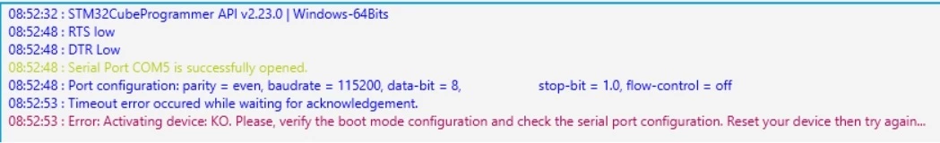

Good morning,
I checked again and it doesn’t work.
Here is what’s happening
Note: the bicolor led on the board is always red, maybe this is an indicator that ST-LINK is not ready ?
Thank you
Stefano
Karl Yamashita
Aug 24, 2026 7:33 AM UTC
In STM32Cube Programmer, you’re connecting as UART. You need to connect by ST-LINK and program the bin, hex or elf file using SWD.
From the schematic, the boot pin on the STSPIN32G0B2 has no boot button so you can’t use the built-in system bootloader. You have to program by ST-LINK SWD.
