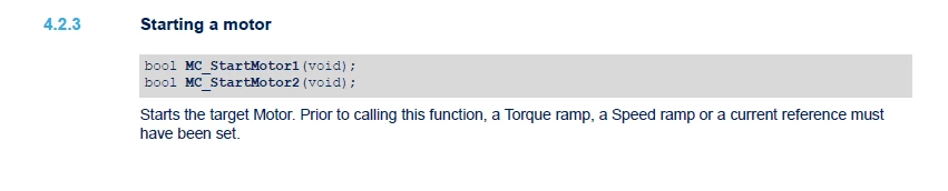

I found the following information in the MC Docs.0693W00000Y7MZcQAN.pngMy question is, if I use Hall Sensors as speed sensing, which of the above (torque ramp, speed ramp or current ref) do I set in order to start motor successfully?

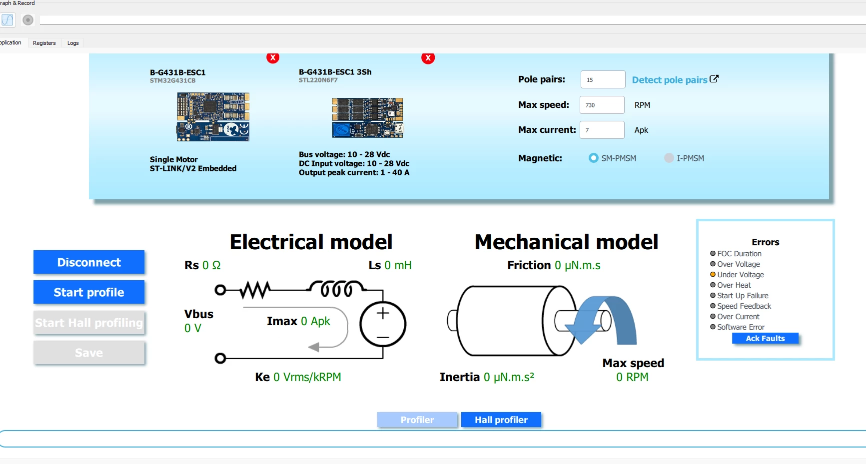

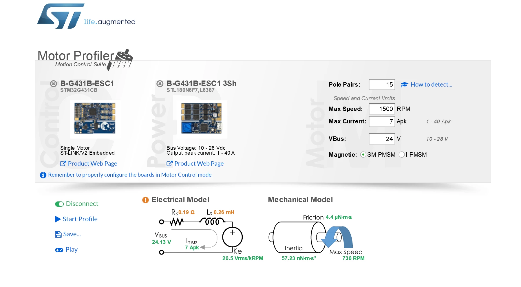

I have profiled previously mentioned motor using both MC prof 6.0 and 6.1.
6.1 seems to have voltage issues since there is no max voltage parameter that we can input. I either get undervoltage or overvoltage faults. Let me share the pictures:
MC profiler 6.0:
MC profiler 6.1:
0693W00000Y7OSEQA3.png6.1 has voltage calculation issues. The profiling fails every time. Please note that I'm not even giving extra RPM (730RPM) in 6.1, while I have actually provided 1500RPM in 6.0 and it still profiled fine for 730RPM.
Also, I'm not able to profile Hall Sensors.
I have disassembled my motor so I can see the order of Hall Sensors placed in the Motor. I might be going wrong in the "Placement Electrical Angle". I've provided it has 60 degree right now.

I have tested both 6.0 and 6.1 MC profiler and I can clearly see issues with 6.1.
About my review on the new profiler software:
I followed your instructions from previous message, and the motor stops moving after 25% profiling and makes a noise with increasing frequency (similar to the sound achieved when revving electric bike) until a over/under voltage error pops up. All this while the motor does not spin. Hence, I believe the new profiler needs more development.
I was able to profile both my motors (36V and 24V) using 6.0 and the same 24V controller (B-G431B-ESC1) and I achieved 600 RPM and 730 RPM respectively for both motors. (600 RPM only for 36V motor because I'm profiling it with 24V controller and supply).

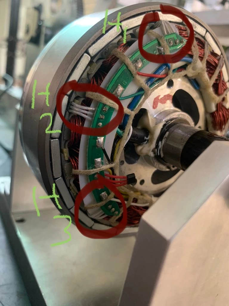

I want to develop my application using the profiles I have with me at the moment. Can you please help me find the phase shift between my hall sensors (placement electrical angle)?
Please find the image of the hall sensor placement in my motor below:

The easiest way to find the "electrical angle placement" is to get the 6.1 profiler to work, as it has a feature to detect this.
