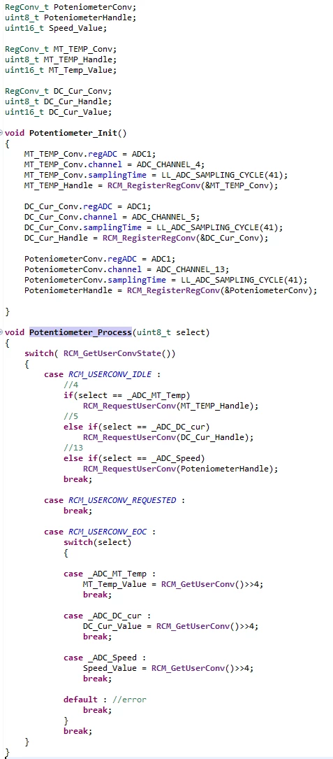

I wanna get to multiple value using RCM Function.
main.c
It's not working.
(Debug mode)
I see everything working fine in my previous application where I used only one ADC channel and one RCM registration.
Why multiple is not working?
How to ?????
