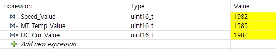

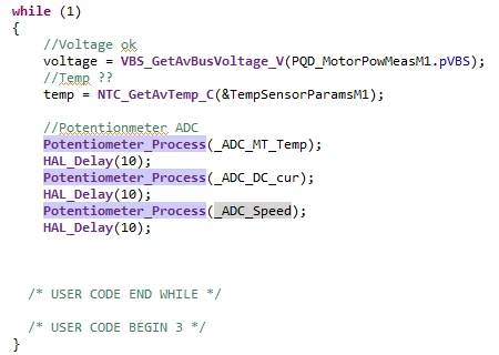

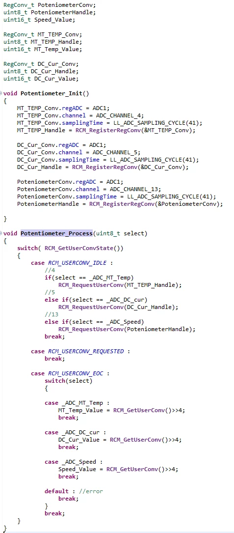

I wanna get to multiple value using RCM Function.
 main.c
Live expression
I see everything working fine in my previous application where I used only one ADC channel and one RCM registration.
Why multiple is not working?

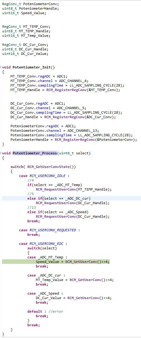

main.c

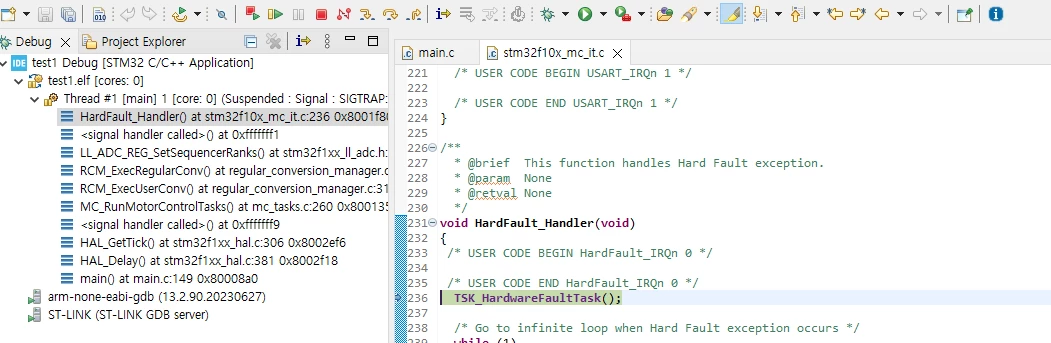

It's not working.
(Debug mode)
