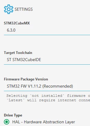

I use MotorControl Workbench 5.Y.2., STM32CubeIDE 1.8.0, STM32CubeMX 6.3.0.
At least this version configuration allows me to upload the project into the board.

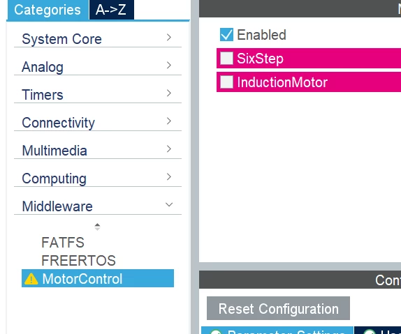

Instead, I click 0693W00000KZsgaQAD.pngIt opens STM32CubeMX, where I can find some yellow triangles, magenta lines and all green ticks on a "System View".
I am leaving everything intact, including:
0693W00000KZsi7QAD.pngI am clicking 0693W00000KZsilQAD.pngIt generates the code and kindly allows me to "Open Project" that brings me to STM32CubeIDE 1.8.0.

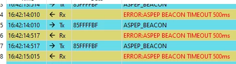

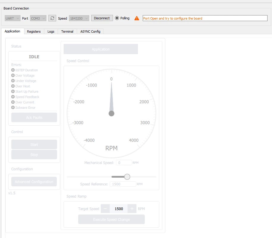

Launching the Motor Pilot. Connecting to the board. It sort of connects:
0693W00000KZsqVQAT.pngGUI is inactive and I am getting this nonstop:

Why I cannot connect via UART with both examples loaded, at any baudrate, including 9600?

Hi, I have exactly the same issue and behavior as you described.
I tried all baudrates (including changing them in ST Motor Controller Workbench -> Digital I/O block), and probed UART line with oscilloscope on the J7 of the STEVAL-SPIN3201: I see that ST Motor Pilot sends some data from PC, but the board never replies.
Apparently the support for this board didn't age well. Were you able to make it work from your side?

For the record, I was able to make it connect using version 5.4.8 of Motor Control Workbench of (the oldest one available for download as of today) with STM32CubeMX v6.6.1 and STM32CubeIDE v1.10.1.
Still, it's not very stable: it works best on 9600, often takes multiple attempts to connect and disconnects often.

The generated code "as is" did not work for me.
Alessio from ST kindly suggested to replace the code in one of the files as per thread:
https://community.st.com/s/feed/0D53W00001Z7xFOSAZ
You will need to replace this code every time you changed something in settings.
You can (and I believe have to) use 5.Y.4.
The communication works well.
Another valuable note from Alessio: Do not change much parameters in GUI:). i.e. If your motor is sensorless and you selected 6 step algorithm - leave it hall censored in GUI.
Good luck:)
