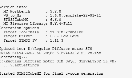

Tried to get it working with the example and MCSDK_5.Y.40693W00000QLEH6QAP.pngsaved it on an empty location and no rename
0693W00000QLEJ8QAP.pngChange nothing for the moment and pusg the button arrow down
What do I choose as Drive Type option HAL or LL ??

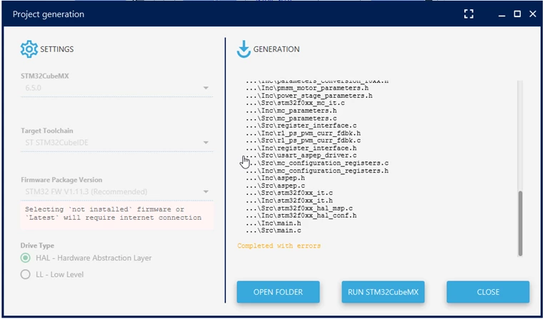

Use LL according to some posts I read and push UPDATE
0693W00000QLEJwQAP.pngHere we are received Complete and then what should i do ???
You get OPEN FOLDER or RUN STM32CubeMX or Close
But how do I get it in my board ???
Do I need another program ??

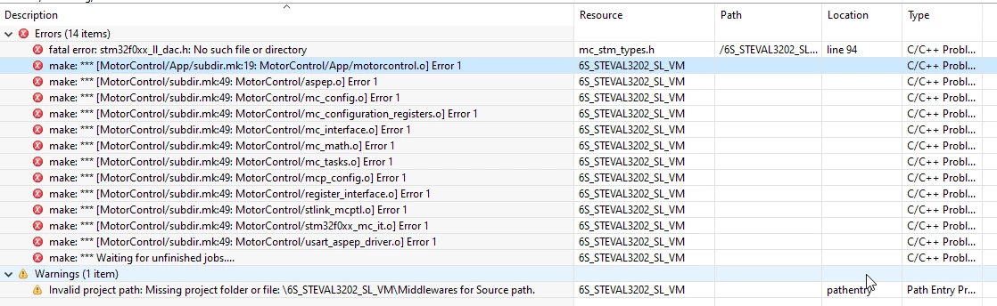

And now I get a DOS box with the following :
Omitted it because what the hell ???
Push the Run Button and the we have :
0693W00000QLEXZQA5.pngA lot of errors ??? and a hugh amount of code .
Searched on my drive stm32f0xx_ll_dac.h" and found it ??
  • D:\MotorTest\6S_STEVAL3202_SL_VM\Drivers\STM32F0xx_HAL_Driver\Inc
How can I solve the above errors ? or Handle I it completely wrong

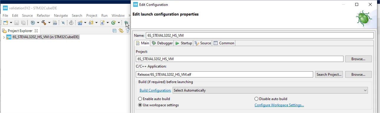

How do download it in to the board ? Is it hex or bin file ?? With what the IDE ??

When you choose the example, a readme.txt pops up with some tips (as usage of IDE e.g).
Could you try by using STN32CubeMX: 6.5.0?
Once compiled, IDE will download directly .elf file:
0693W00000QLQ74QAH.pngBest regards.

Hello, download the 6.5.0 and tried again but unfortunately I get a bunch of errors see log file.

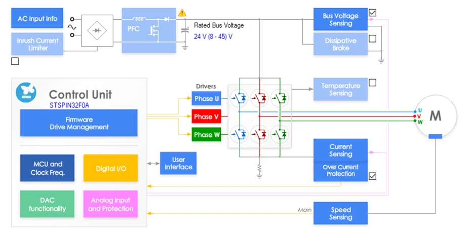

Also I saw although I selected Senserless and Voltage mode via STMCWB :
0693W00000QMwSaQAL.pngI see connection lines for the speed sensing :
0693W00000QMwSpQAL.pngBut still I continued just to see If I can compile an download it.
Hereby the log file after :
0693W00000QMwTYQA1.pngOf course I persist to complie it but of course also there errors:loudly_crying_face:
Shouldn't be that hard i think really spent more then a few days here.

Back from holiday . Tried the above tip :STN32CubeMX: 6.5.0 .
Isn't working either ?? Nobody ?
