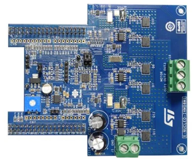

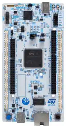

How to connect X-NUCLEO-IHM08M1 with NUCLEO-H563ZI?
Hello All
Does anyone know how to connect X-NUCLEO-IHM08M1 with NUCLEO-H563ZI?
I would to evaluate it with MC workbench 6.0.3.  However. I am not sure how to connect it together.
It looks like I CAN'T plug it directly, because the slot and pins are not matched.

    Hello yang2,
    As you said, X-NUCLEO-IHM08M1 and NUCLEO-H563ZI can't directly be plugged together, you need to solder pins on the CN11 and CN12 connectors of the NUCLEO-H563ZI to do so. H563ZI CN11 goes with IHM08 CN7, and H563ZI CN12 goes with IHM08 CN10. Be careful to keep the pins in the right order (Number 1 pin on number 1...) The first two pin numbers are written next to their respective connector for each board.
