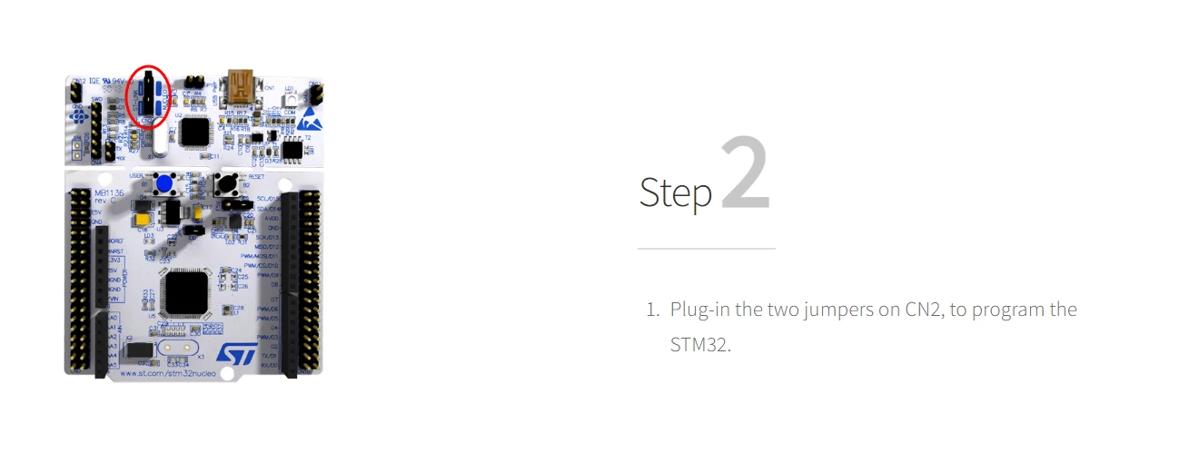

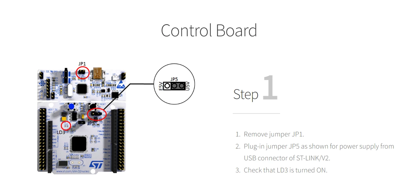

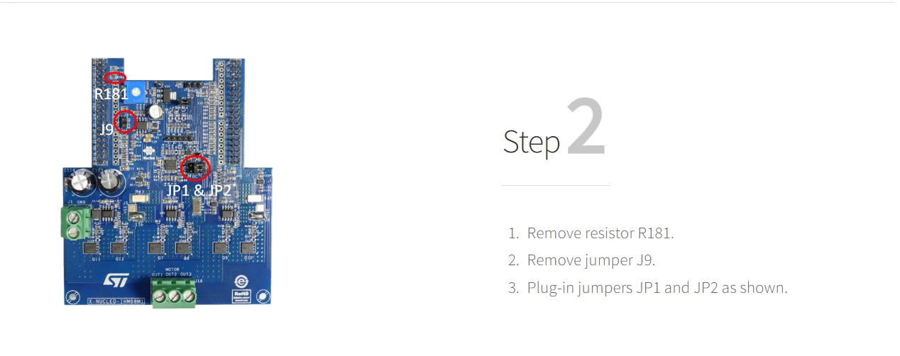

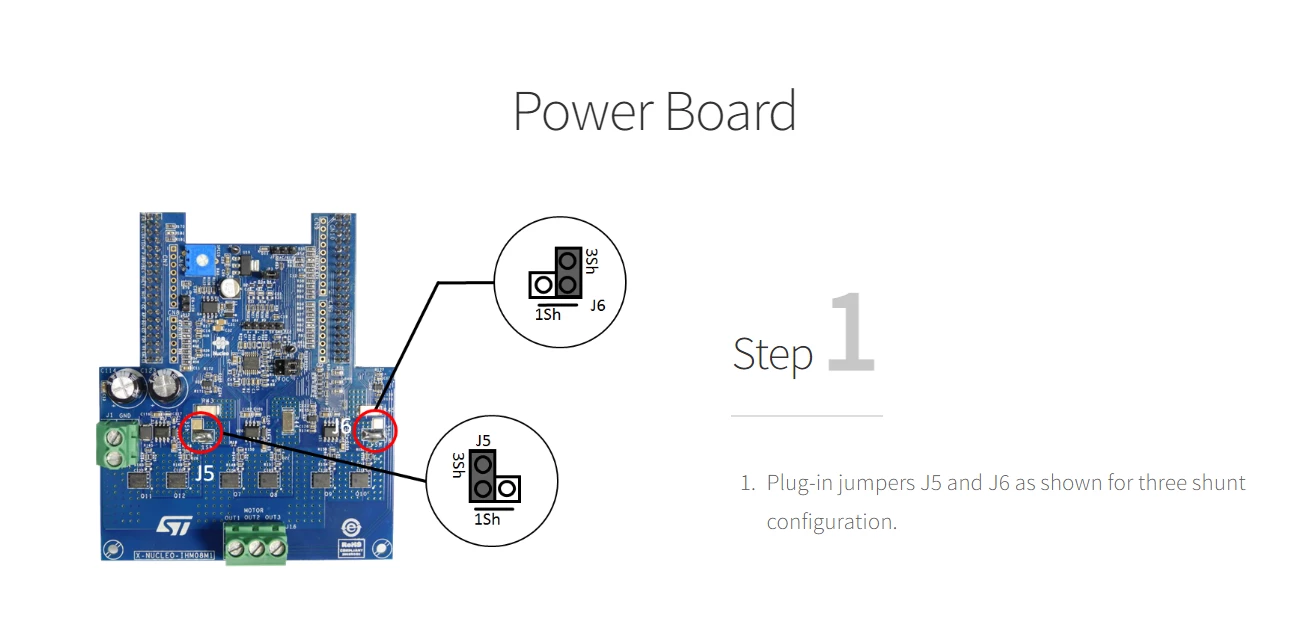

Initially i powered the board by following the steps provided by the st motor profiler. I have tried with Motor control work bench 5.4.8 and 6.3.0. First i tried with 5.4.8 the motor profiler was running but stopped at 94% indicating to check the MAX RPM part in the motor control profiler. After that i tried with 6.3.0 but in that the code was generated with error, so while compiling it was showing some.h file not found. Again when i tried with 5.4.8 it is showing over current error at starting only.
Additionally i have removed C5,C3 and C7  as suggested in the vedio
 https://youtu.be/qB7jJqCr72U?si=K-o0B9kFZTxo9RVP
