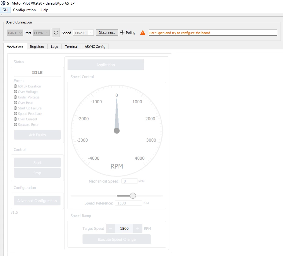

How to configure the board for experimenting in MotorPilot with STEVAL-SPIN3204? The PC recognises the evaluation board and I followed the steps in the MotorPilot manual. But I always get warning - Port Open and try to configure the board.

Hello @KSpeh.1​ ,
What is your MCSDK version ?
Unfortunately we introduced a regression in the 5.Y.4 release concerning STM32F0 series using USART1 and USART3. (STSPIN32F0B is build on top of STM32F0)
Release 5.Y.3 is not affected and I suggest you to move to this version.
Regards

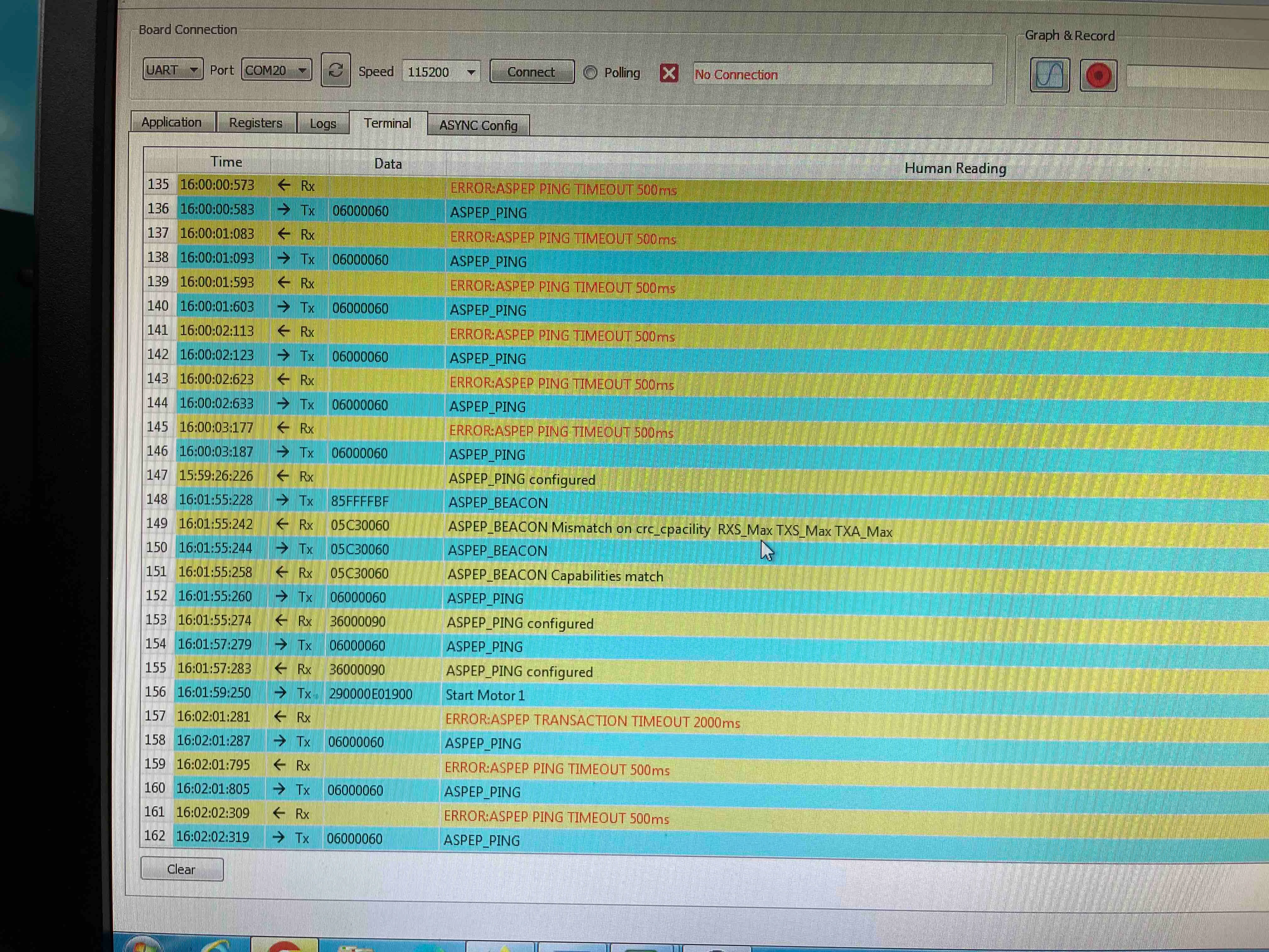

Nevertheless new problems arise: As soon as I want to send an instruction through ST motor PILOT, I get the message Port Open but no answer from board. I have to uncheck Polling in order toi have a stable connection otherwise the above error message is displayed and connection lost. Here is a screenshot of what happen when I send START command for example.
Best Regards

Hello David,
I think your issue comes from your baudrate. 115200 is too slow.
With the new protocol we set it by default to 1843200.
You can change it through cubeMx or directly from your main.c, and of course on the Pilot too.
Let me know if it works.
Cedric

Hello Cedric,
Exactly the same issue with a baud rate set to 1843200 in main.c and in motor control.
Just after connection established, I get in the terminal the message "ASPEP_BEACON Mismatch on crc_cpacility RXS_MAX TXS_Max TXA_Max" and connection is still alive.
As soon as I click on START button (for example, but it's the same results with all other button) I get the the error message ERROR: ASPEP TRAN?SACTION TIMEOUT 2000 ms and connection is lost.
Another idea?
Regards
David
