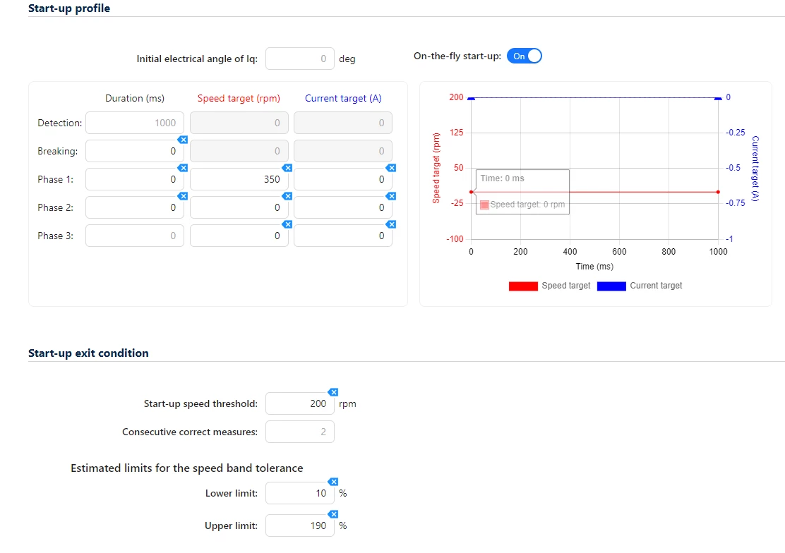

When I try to start my motor by programming a torque ramp and starting the motor, if the motor fails to start, the motor state moves to FAULT_NOW with a startup error. The real issue is that I don’t know how to clear the fault. The state never changes to FAULT_OVER so I can never acknowledge the fault. I wish I could try to restart the motor without having to totally power cycle the system to clear the fault. How do I get a startup fault to transition from FAULT_NOW to FAULT_OVER?

    captatAuthor
    Jul 11, 2024 12:20 AM UTC
    I am using MCSDK 6.3.0 and STM32CubeMX version 6.12.0, just updated everything recently.
    The .stwb6 file is attached (with .txt extension). I modified example control and power boards to match a custom motor driver board so reproduction may not be feasible. It is an FOC project with three shunt resistor current feedback in torque control mode. The "on-the-fly" start up parameters are pictured below. My intention was to have the motor only start up if it was already spinning at least 200rpm, maybe I have done that incorrectly.
    I have connected to the Motor Pilot desktop software, and I get basically the same result, when I try to start up the motor, Motor Pilot shows a start up error and remains in the FAULT NOW state indefinitely.
    I did have this working before, but things seem to have broken when I re-generated the project.
    However, I'm suspicious that it may be related to this issue recently explained here: https://community.st.com/t5/stm32-mcus-motor-control/mc-6-3-with-mx6-12-attr-not-supported-dmpu/td-p/694578
    Basically, there is an error during the project generation saying "Attr not supported : Dmpu" So the project generates with errors. I'm not sure what this error means, but its probably not a good idea to rely on a project with errors!
    I know there are a lot of variables here, especially with the custom hardware that I'm using, and I just dumped a lot of info here, so no expectation for a complete solution. But any pointers would be appreciated!

    It seems that there are two issues here. The first one is that you are experiencing a Start up fault, and it should be possible to solve this via tuning.
    However the Start up fault should not be permanent, which is the second issue. I find this one more concerning as it implies an error in the state machine. You mentioned earlier being able to run the project before, could you try to recreate such a project, and try comparing the two of them ? Also, could you tell me what you have changed before re-generating ? Of course, if you could send me the working project for me to also compare them, that would be perfect.
