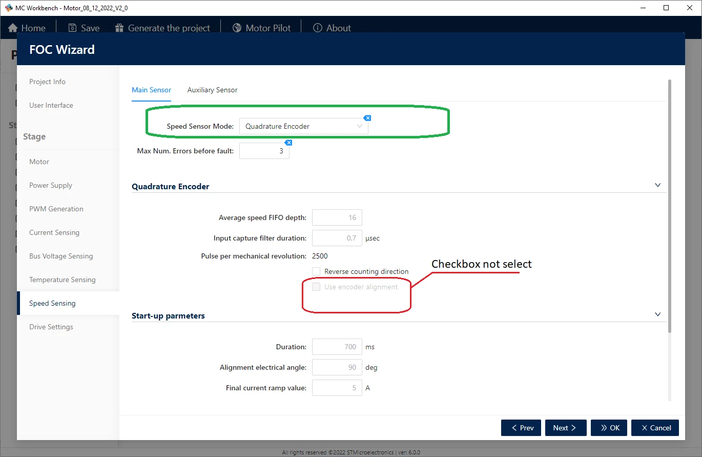

How to check the Encoder Alignment checkbox in ST motor control SDK 6.0.0?
I use ST motor control SDK 6.0.0. Why is the checkbox "Use encoder alignment" not active? All required options for encoder are set.

Dear User,
I am sorry to tell you that the problem you reported is a missing feature of MCSDK 6.0. You need to activate the encoder alignment yourself in the generated code.
However you will be pleased to know that the next release of the MCSDK will be accessible in the following weeks and that the issue you reported was solved.
Thank you for your feedback,
Best regards,
Gaël A.
