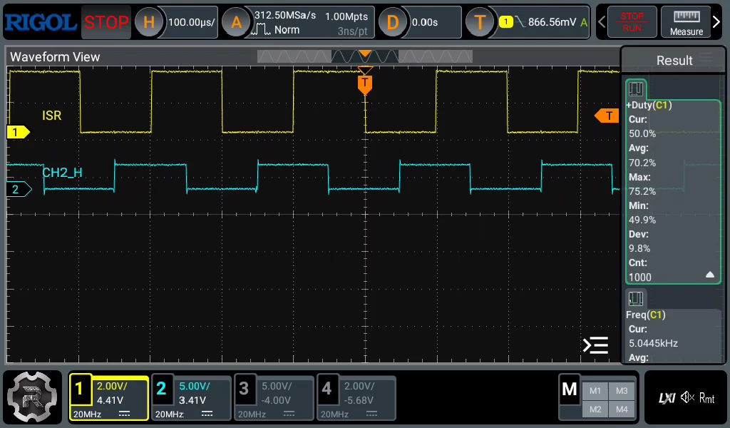

I have inherited some code where a 5kHz 50% PWM is output in center aligned mode using TIM1. CK_PSC is 275MHz, CK_CNT is 137.5MHz (I think) because PSC = 1.
The pattern output matches the implementation:
The yellow trace is a GPIO pin that is toggled in the ISR HAL_TIM_PeriodElapsedCallback().
I want to to keep the same 50% duty but half the frequency to 2.5kHz using the prescaler.

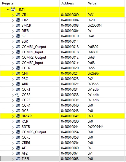

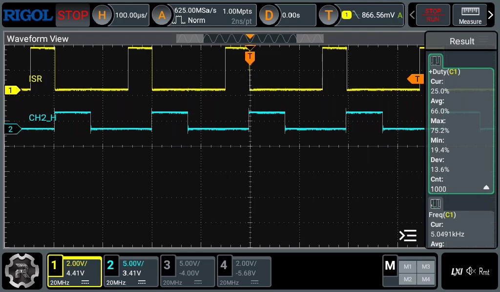

From the TRM, it seems I just have to modify PSC from 1 to 2. However, when I do this by poking the SFR register using the debugger, I get the following output:
As you can see, the PWM ratio changes but the frequency does not. I’m at a loss to understand why. So would be grateful for any suggestions.
Thank you.
In case it helps, here’s my register dump. I have no idea what DMAR is that is my next step.

Always start with stating, which STM32, and perhaps add, what harware and what software are you using.
TIMx_SMCR=0x200004 means, that some external source (possibly another timer) resets this timer. In debugger, set SMCR=0, you should see again 50% duty and 3/2 of the original period (see below).
Prescaler is (PSC+1), i.e. 1 is prescaler 2, and 2 is prescaler 3. If you want half the frequency, use PSC=3 (ie. prescaler 4).

Setting TIMx_SMCR to 0 fixes the problem. I can now adjust PSC only and keep the duty cycle.
I found that some other part of the application was changing the Slave Mode after the MX initialization which was set to Disabled.
