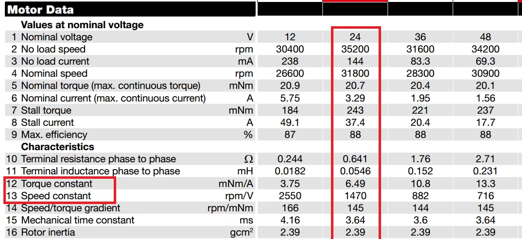

Hi, I'm working with an Maxon 3-phase 1-pole BLDC motor, following is it's motor data table or attached file. the colum with red rectangle is the motor type we're now dealing with.

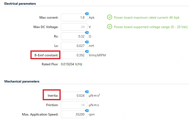

I wondering how can we get the B-EMF constant in the MC workbench electrical parameters from this motor data.
And what's the speed constant related with B-emf constant. isn't it b-emf constant reciprocal ?

    You can easily get your BEMF constant using our provided MotorProfiler tool, please update your MCSDK version to our latest (6.2) if you have any profiling issue. It is delivered within the MotorPilot tool. you will find its startup guide right here. This will allow you to create a configuration file for your Maxon motor. It will be saved as a referenced motor and you won't need to manually enter your motor's characteristics every time you want to build a project.
    Your B-G431B-ESC1 inverter board should be able to run your motor, also be aware that this board is intended to be used with a cooling device (usually a fan), as it may heat up very quickly. If you want to proceed with the profiling (and running) without any cooling device, you may need to lower the max current when profiling, so it can end the profiling without potentially damaging your board. You will get wrong max speed, but the other parameters will be calculated correctly. You can then edit your Motor file manually to change the max speed.

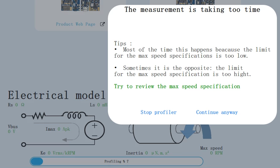

    We have tried profiling this motor before, but the Profiler just can't come to 100%, it always stays at 7%, sometimes may reach at 14%, and why giving us that the max speed specification should be reviewed? the max speed is cirtical in the profiling process?  The max speed we set is 30000 rpm and  max current is 3.29A, when profiling.   Any suggestions? Thanks!profiler.PNG

    Hello jflash,
    May I know the Profiler version you are using on which you are experiencing issues ?
    Please make sure you have our latest version installed (MCSDK 6.2) ; it provides a few fixes concerning Motor Profiler.
    If you are still experiencing the same kind of issues, you can also try tinkering a bit with the Max Speed and Max Current values, reducing them for instance. This will not hinder the calculation of your BEMF constant.  Your motor configuration file will get wrong Max Speed and Max Current values, but you can still modify them afterwards.
