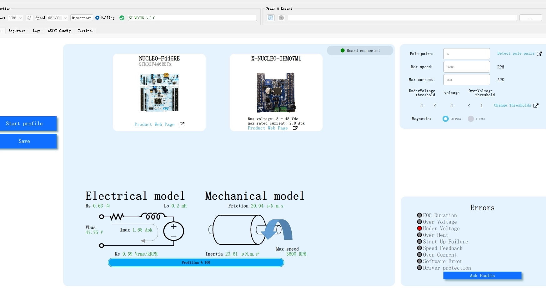

I refer here:https://wiki.stmicroelectronics.cn/stm32mcu/wiki/STM32MotorControl:How_To_manually_configure_the_motor_parameters

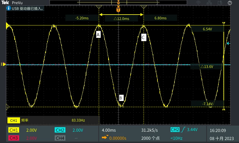

Below is the profiler's result. Ke=9.59 Vrms/kRPM.
Below is my owm test.
Vpp=13.6v,pole pairs=5,fbemf=83.33Hz. Ke=(13.6*5*1000)/(2√2*83.33*60)=4.8085 Vrms/kRPM.
I wonder if I chose the wrong frequency?Is it between point A and point B or pointA and pointC?Thanks.

    Hello @gtop.1,
    The frequency you chose is correct. I would be more in favor of definition issue regarding the pole pairs number to explain your factor 2 difference between the profiler output and your computation.

    Could you describe accurately how did you generate the oscilloscope dump ?
    How did you spin your motor for instance ?
    Cedric

    how did you spin your motor to generate your waveform, did you plug it to any electronic other than the scope ?
