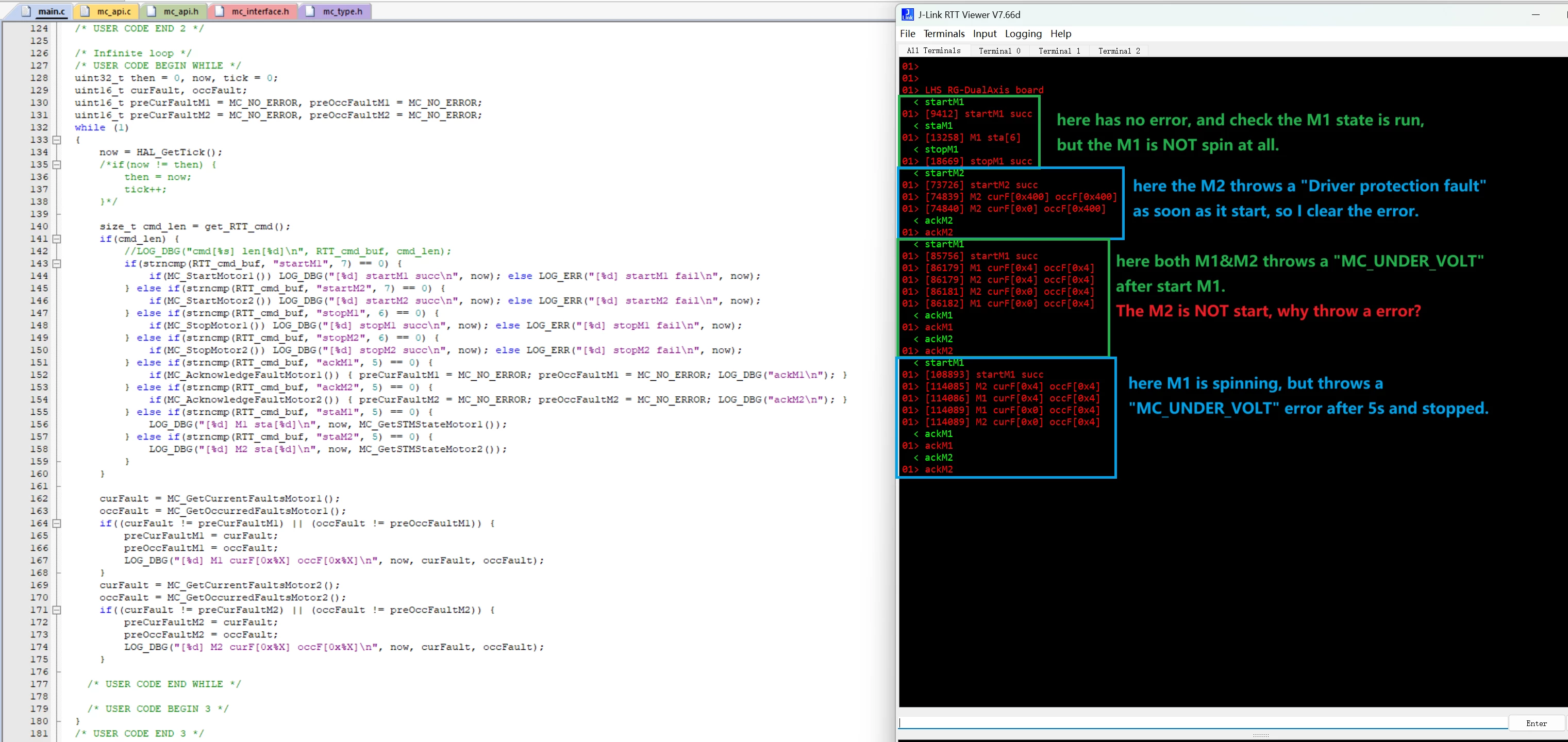

Hi there,
My team has designed a dual motor control board, and I'm responsible for spinning the motors.
I have already added the board to MCSDK6 and generated the project without error.
However, when I add the code like MC_StartMotor1() after initialization, both the motors are static.
I don't know the reason why the motor can't spin.
Find the board file and the schematic in the attachments.
Can someone help me double-check if I did something wrong?
Thanks for your help. May you have a goooood day!

Have you verified if the motor gone to RUN state and not in fault state? Did you verify the PWM at the Gate Drivers etc, some of the very few inspections.

Thanks for your reply.
I checked the state of both motors, and the phenomenon was as follows:
Given the identical input, the output varies wildly. I can't figure out why.
Could you give me some advice?
Thank you.
(The following is the code I added. The log file can be found here: GitHub - ShadowThree/dbger)

Senior III
I never worked with dual motors but my suggestion would be to make one motor running smoothly without any faults and then go for dual motors testing.
Verify the threshold levels of fault parameters of voltages,
Verify the current sensor circuitry.
Record the voltages and currents and check them for valid ranges.
