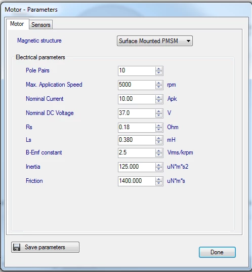

When not using the motor profiler and instead writing all details by hand into the Motor Control Workbench (with Hall Sensors, Manual editing of PI variables disabled) at Motor - Parameters, there are fields for Inertia and Friction. So far, so good. Just the units are a bit confusing:
Inertia: uN*m*s2
Friction: uN*m*s
I thought that inertia had the units kg*m² and friction N*m, which I wasn't able to match with the given units.
Any clues how to do this right? Also does u stand for micro in this case or for something else?
Thanks,
Martin

Posted on May 15, 2018 at 16:30
Hello Mr. Martin,
Yes sure, you are right, in that form the units are a bit confusing. Thank you for reporting this problem, we will try to improve them.
About 'u', yes, it
stands for micro (1E-6)
and
`N` stands for Newton the
SI
unit of Force(
1 Newton is equal to 1 kg
m
s-2)
https://wikimedia.org/api/rest_v1/media/math/render/svg/07948745d4db778de832933915f84be8bd9b4ded
So: N·m·s² = kg·m²
Hope this can help.
Best Regards.

Posted on May 16, 2018 at 08:27
Nice, Palano. That works perfectly for the Inertia.
Can you also explain how to make sense of N*m*s instead of N*m? Or explain what kind of friction is meant here if not frictional torque?
Many thanks!
M. Palano
Posted on May 17, 2018 at 14:43
Hello Mr. Martin,
As you correctly said, the unit of measurement of the Friction Torque is [N·m]
The item required in the form of our tool, measured in [N·m·s], is the coefficient of the Friction Torque.
Friction
Torque
[N·m] :
TF
=  Î²Â·�?‰
where �?‰
is the angular velocity (Rad/s) and Î²
is the coefficient required by MC-Workbench [N·m·s].
If not directly available, the the ST-MotorProfiler could be an effective way to detect it; in alternative, use external equipment like torque meter and speed meter.
With Best Regards.
