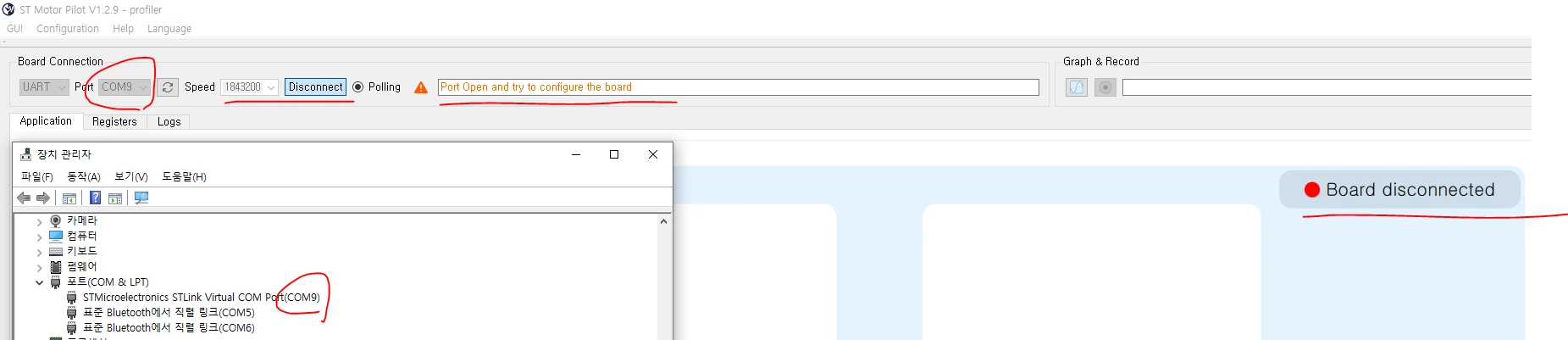

The Motor Pilot_6.3.0 program does not connect using UART.(Discover Board / Launch Profiler)
(Figure3)
Even if I change the UART Speed, the "Port Open and try to configure the board" error only appears.
(Figure4)

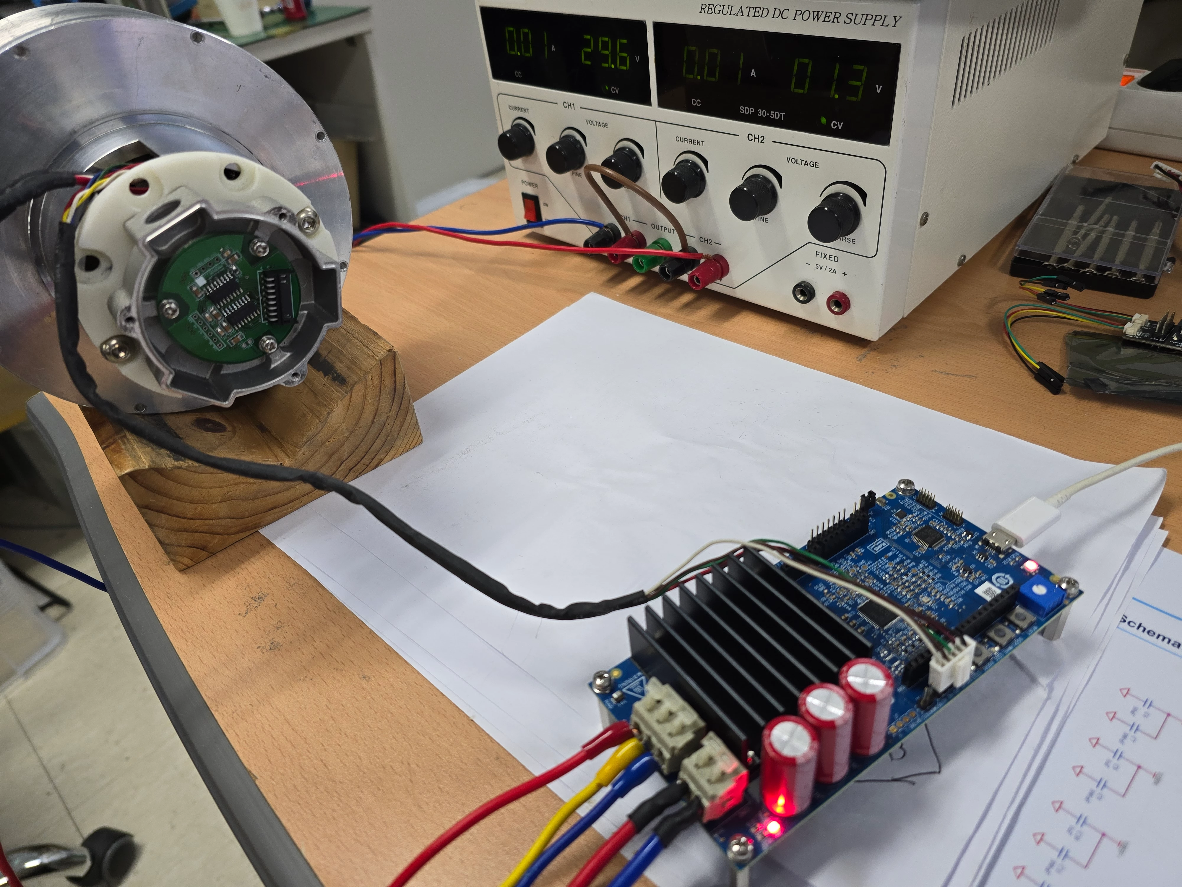

I bought EVSPIN32G4 to run the motor at 60v voltage level.
However, I understand that motor measurement is currently not possible with the Motor Profiler 5.4.8 program.
In that case, you need to measure it in the Motor Pilot_6.3.0 program.
I can't check anything because the connection isn't working.
MC_Workbench cannot create a project because there is no motor with similar specifications.
Since I cannot receive the motor value from the motor manufacturer, I have to proceed through measurement. Please tell me how I can do this.

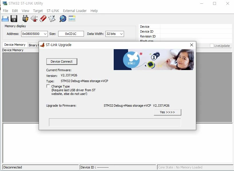

After purchasing EVSPIN32G4, I only updated ST-LINK after connecting Micro USB.
It is connected to the motor as shown below.
The board cannot be connected in ST Motor Pilot.
How do I connect?
kelvin.wang
July 10, 2024
MCSDK 6.3 Profile need user to add FW manually by create new project ,you may refer to MCSDK document in "about" ICON and search "Motor Profiler Application Note"
