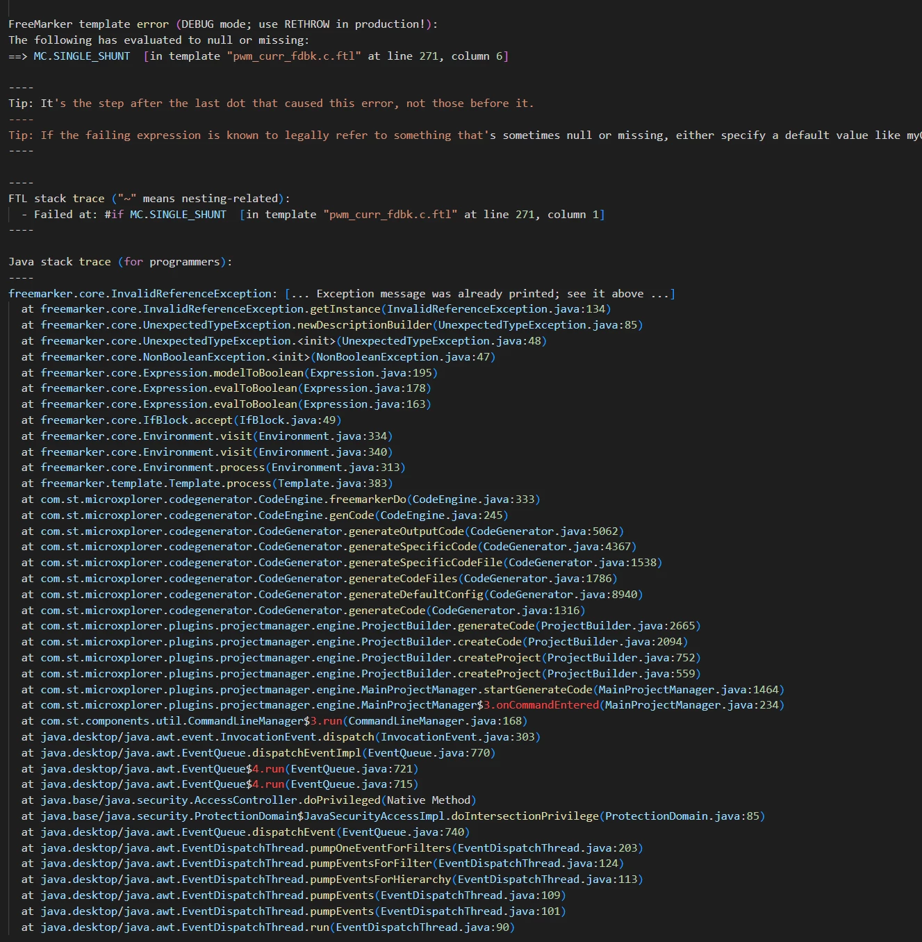

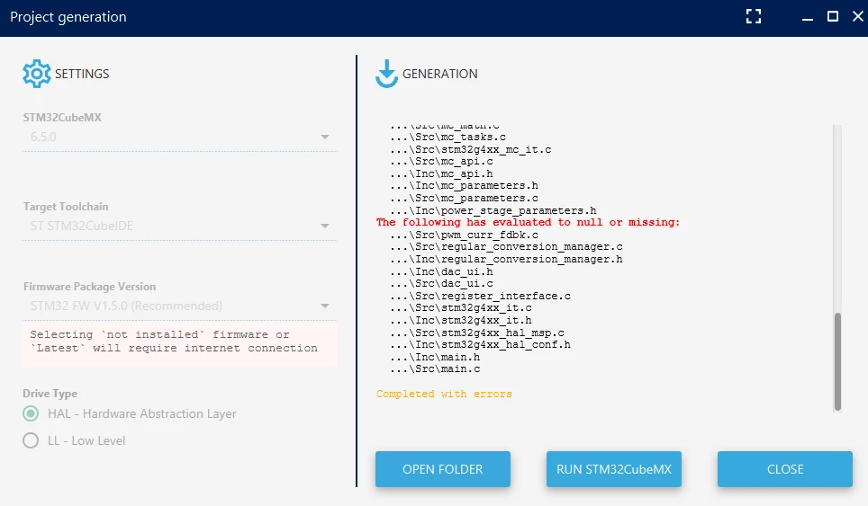

How can I get the example ACIM-NUCLEOG431RB-IHM023V3 projects up and running in MCSDK 5.Y.4?
After rigorously following the instructions numerous times with every possible STM32CubeMX, Toolchain, and Firmware configurations, the build always fails to generate ...\Src\pwm_curr_fdbk.c. The error is that MC.SINGLE_SHUNT is "evaluated to null or missing."
I have tried uninstalling and reinstalling, trying to compile anyway, editing the .web_df file, changing settings in the Workbench, and more.
