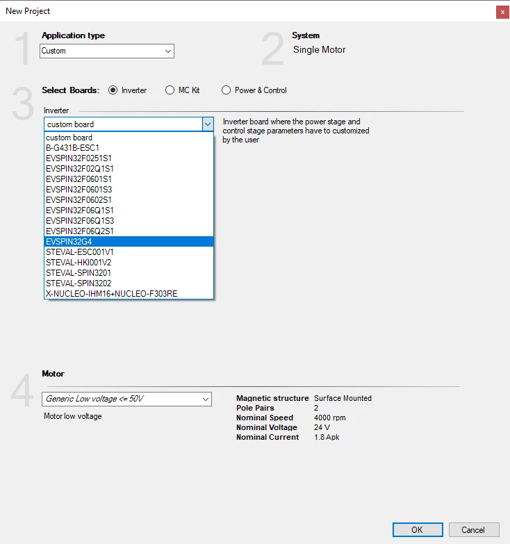

I am trying to control a SPMSM using EVSPIN32G4.
I can't find any example for X-CUBE-MCSDK with EVSPIN32G4.
So, please link for the examples or materials for studying.
Thank you.

Hello @JLee.56​ ,
EVSPIN32G4 is fully supported in the MCSDK 5.Y.3.
you will find it in the inverter section as shown in the picture below
0693W00000HpgKNQAZ.pngRegards
Cedric
